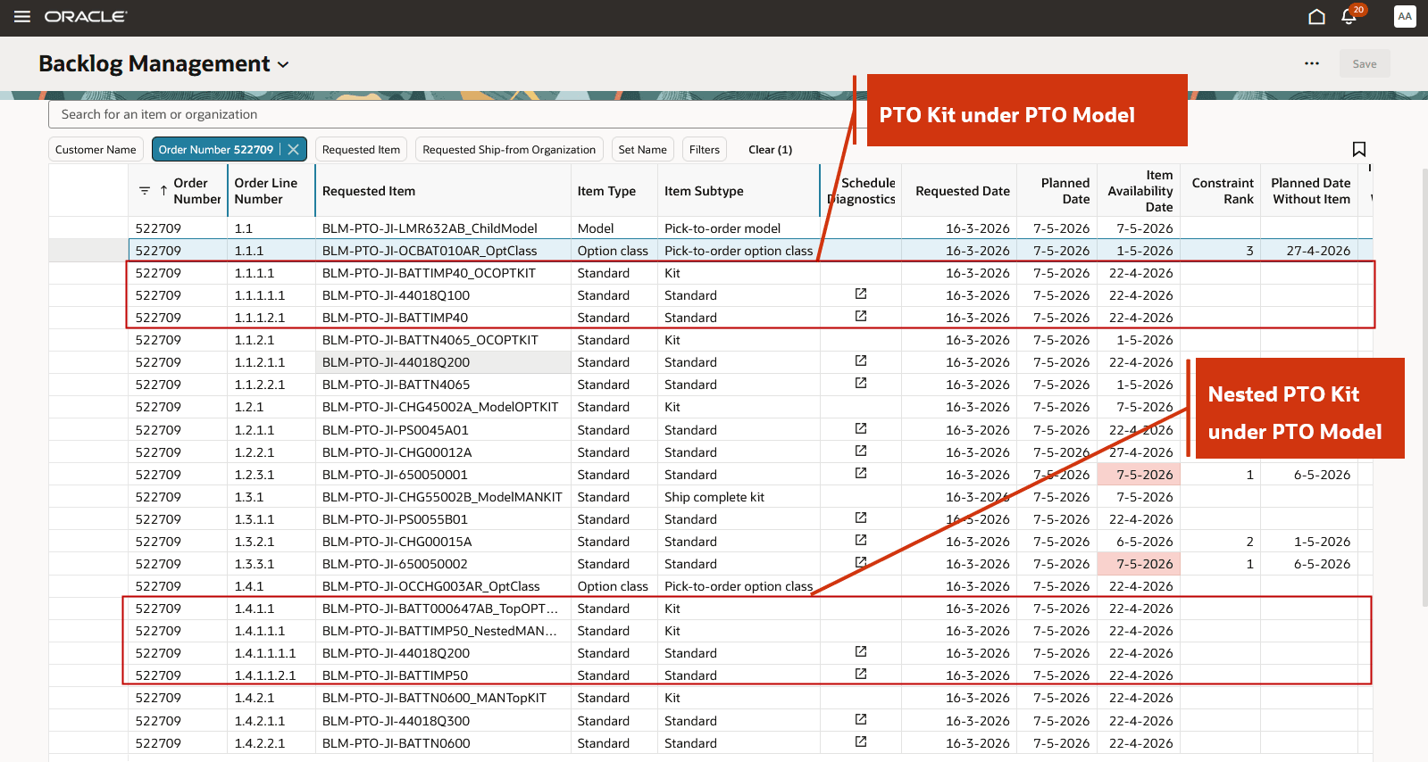

Example: PTO kit under a PTO model
This example illustrates a PTO model order structure (order line 1.1) that includes a PTO kit in multiple roles:
  • As an option item (order line number 1.1.1.1)
  • As a mandatory component (order line 1.4.1.1
  • As a nested PTO kit within another kit (order line 1.4.1.1.1)
PTO Kit under a PTO Model

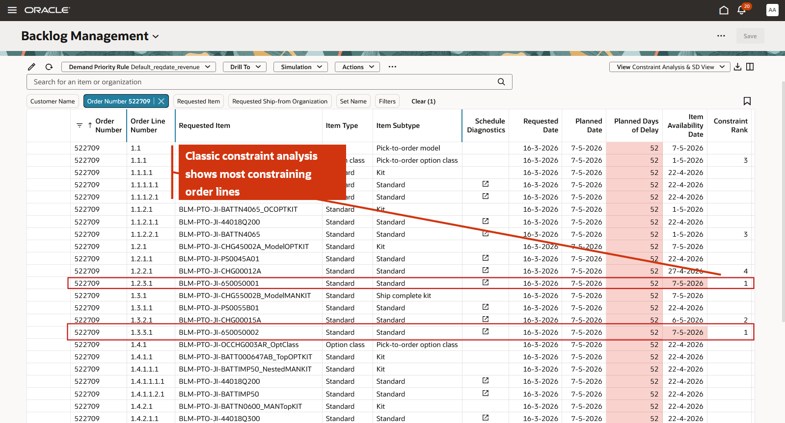

The PTO model is rescheduled with a delay to 7th May, 2026. To identify the causes of this delay, you can use a combination of classic constraint analysis and the enhanced scheduling diagnostics.
The classic constraint analysis shows the constraining lines that contribute to the rescheduling delay. For example, the kit component at order line 1.2.3.1 is identified as the primary constraint, with a Constraint Rank of 1 and an Item Availability Date of May 7th, 2026.
Classic Constraint Analysis Showing Constrained Order Lines

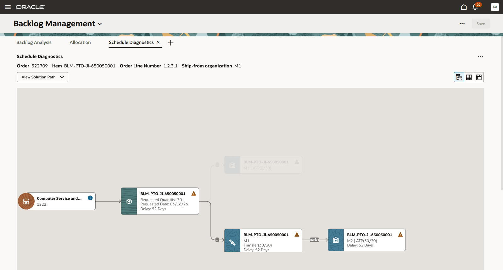

You can also view the scheduling diagnostics for the kit component line. For example, select the scheduling diagnostics icon for the order line 1.2.3.1 to view the detailed information.
The diagnostics indicate that no Available-to-Promise (ATP) supply exists for the kit component at the ship-from organization. Instead, the component is sourced through transfer from an upstream organization M2, where ATP supply is available with a delay of 52 days.
Scheduling Diagnostics for Most Constraining Kit Component Line
