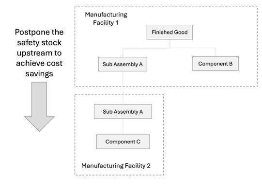

Postponement
Inventory optimization planning applies postponement heuristics to postpone the overall end item safety stocks based on the overall lead times and costs to upstream facilities in a multiechelon supply chain and to components for manufactured items. While doing so, it evaluates possible alternate sources, work definitions, and substitute components to achieve the target service level and to minimize overall inventory costs.
Postponement Across Echelons

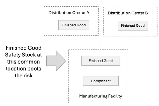

Risk Pooling
Wherever feasible, inventory optimization planning leverages risk pooling at shared (common) nodes across a multiechelon supply chain network. Such pooling of risk at common item-locations in the supply chain reduces the impact of independent random variations in downstream nodes and potentially reduces the overall safety stock inventory.
Risk Pooling Across Echelons
Similarly, risk pooling happens not just for the same item across locations (holding an inventory buffer of an item at a common upstream location that feeds the item to multiple downstream locations), but also across bills of material that share common components. If a component is shared across many finished goods, its prescribed safety stock level will be lower than if the component is used in only one or a few finished goods.

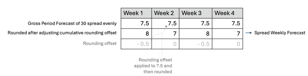

Forecast Spreading
Inventory optimization planning spreads the forecast to the plan buckets evenly, which reduces any unnecessary safety stock spikes. As an example, if the forecast for a period is 30 and the plan is run in weekly buckets, then the safety stock is spread as shown in the following table. This example assumes the rounding control is on for this item and therefore the forecasts will be rounded up.
Example of Forecast Spreading
