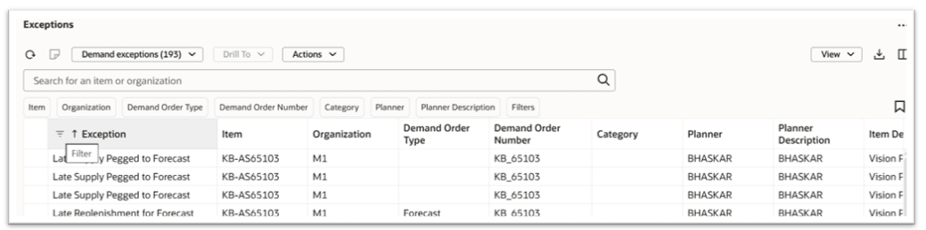

Column filter displayed for Exception column in Demand exceptions group

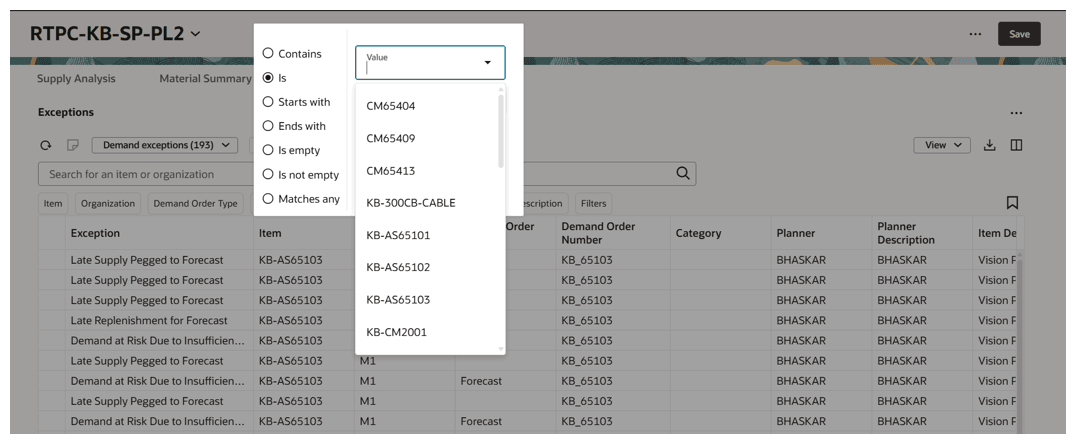

Column filter displayed for Item column which has string data type in Exceptions

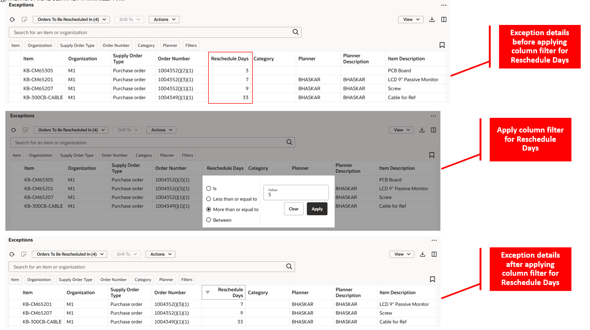

Exception details before and after applying column filter

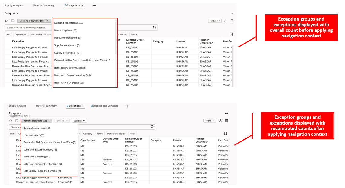

Exceptions page displays relevant details, including count after applying navigation context

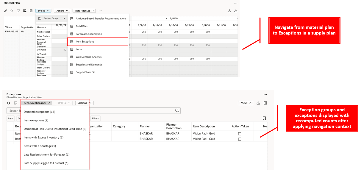

Exception groups and exceptions displayed with relevant details, applying navigation context drill from material plan in a supply plan

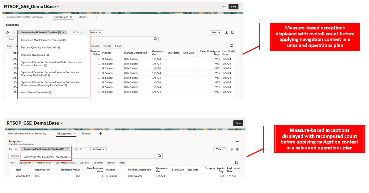

Exceptions displayed with relevant details, applying navigation context drill from Items in a sales and operations plan
