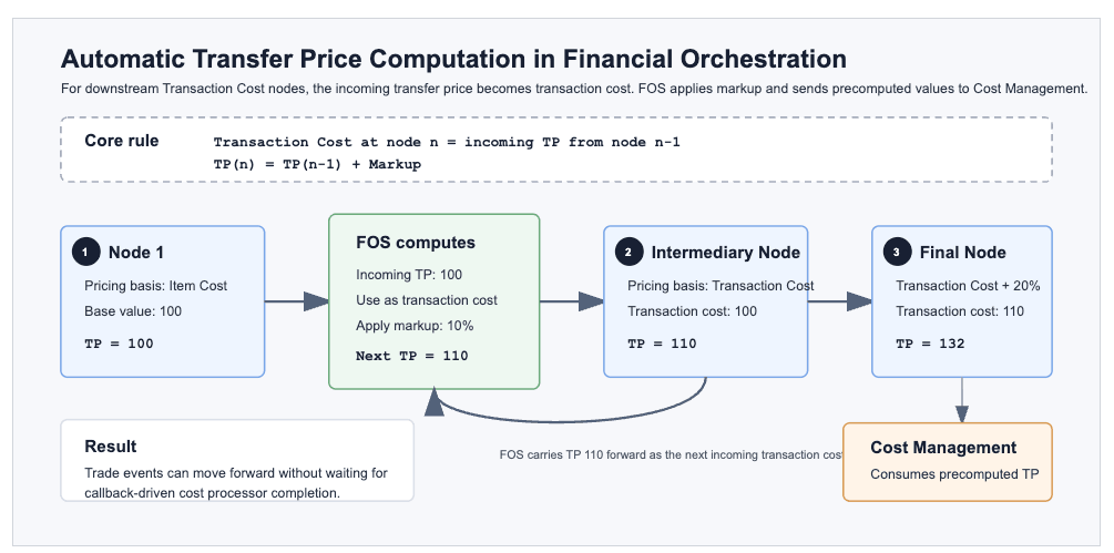

The transaction cost will be the incoming transfer price from the prior node for intermediary nodes. Financial Orchestration will apply the configured markup to calculate the next node's transfer price. Trade In Transit Issue, Trade Receipt Accrual, and Trade In Transit Receipt events can be generated together and sent to Cost Management without waiting for the costing callback.
Automatic transfer price computation in Financial Orchestration
Node Pricing Basis Calculation Transfer Price
Node 1 Item Cost Base value $100.00
Intermediary Node 2 Transaction Cost + 10% $100 + $100 x 10% $110.00
Final Node 3 Transaction Cost + 20% $110.00 + $110.00 x 20$ $132.00
Table outlining the price computation
