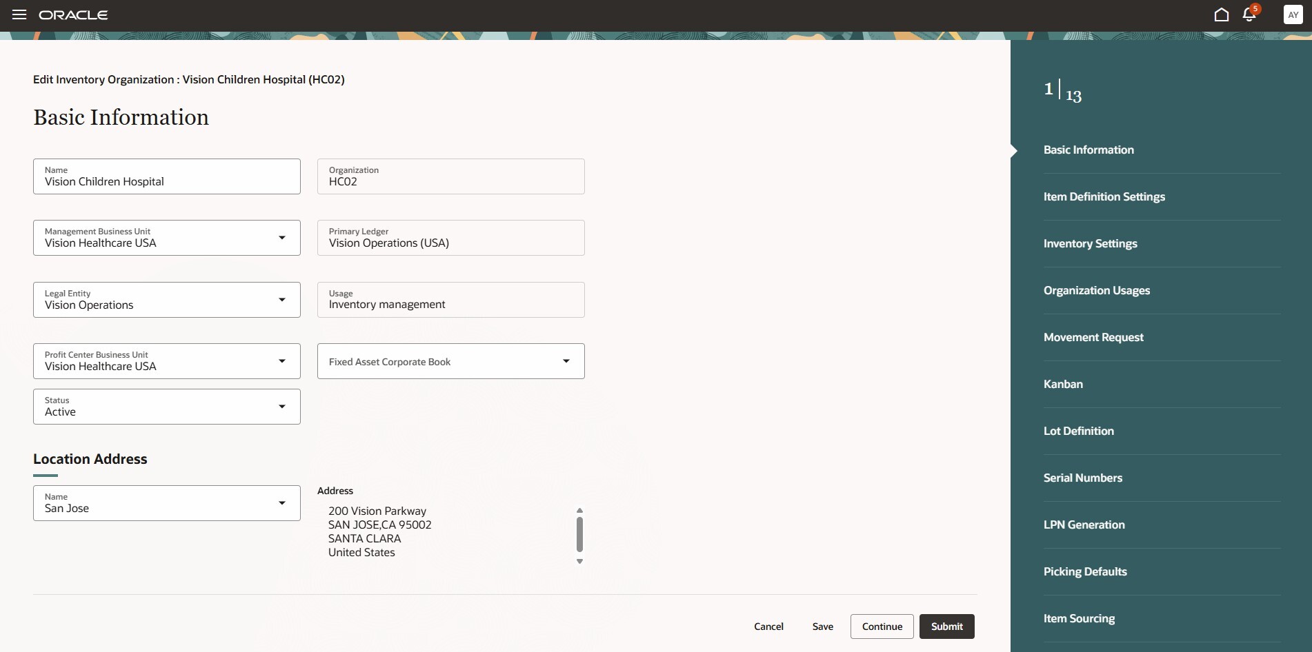

Create and edit inventory organizations and their parameters using a new guided process. The process organizes configuration into a clear sequence of steps, starting with foundational organization details such as business unit, legal entity, ledger, status, and location.
Complete targeted setup steps for item definition, inventory settings, organization usages, movement requests, Kanban, lot and serial controls, LPN generation, and picking defaults.

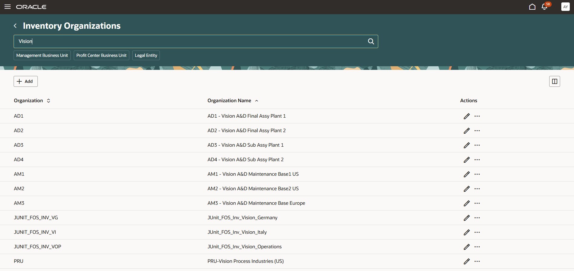

Manage Inventory Organizations
Organization Parameters Guided Process
This guided process helps you define inventory organization parameters accurately and efficiently. Step-by-step guidance makes required definitions easier to find and reduces the complexity of configuration.
