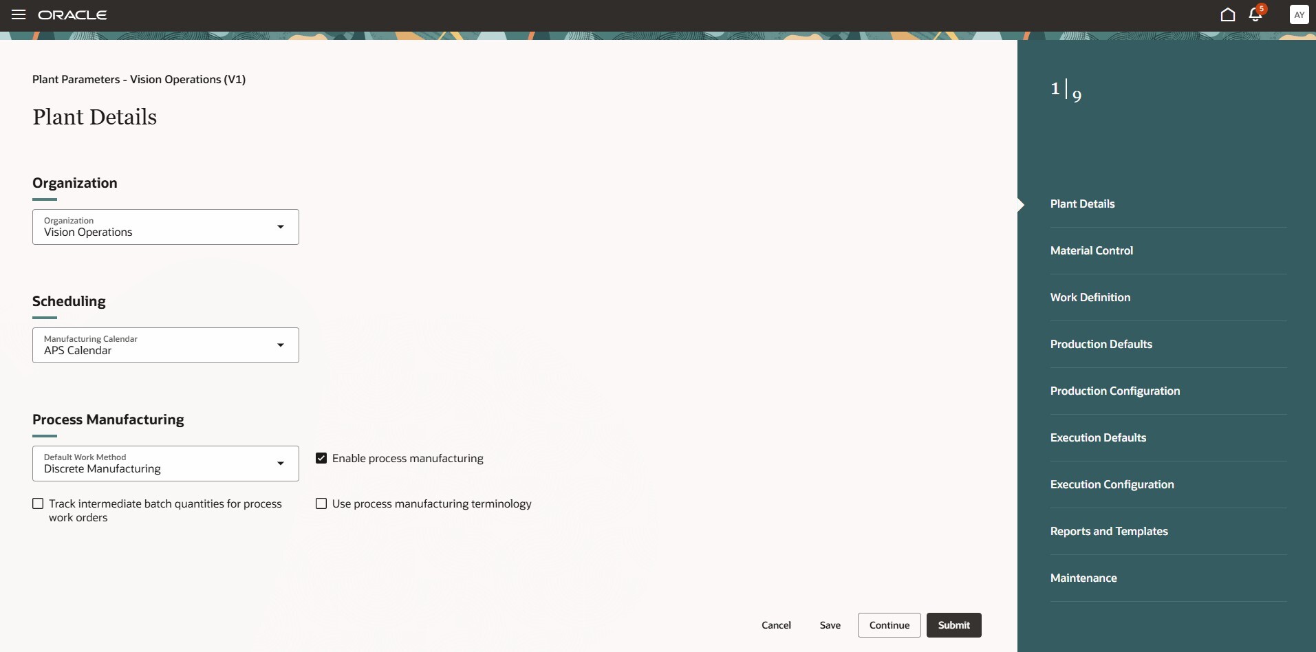

Define plant parameters using a new user experience
Define plant parameters using a new guided process that simplifies the definition and maintenance of plant parameters. Parameter definition is organized into nine sections, including Plant Details, Material Control, Work Definition, Production Defaults, Production Configuration, Execution Defaults, Execution Configuration, Reports and Templates, and Maintenance. The guided experience presents related parameters together and guides users through the process of defining plant parameters.
Plant Parameters Guided Process

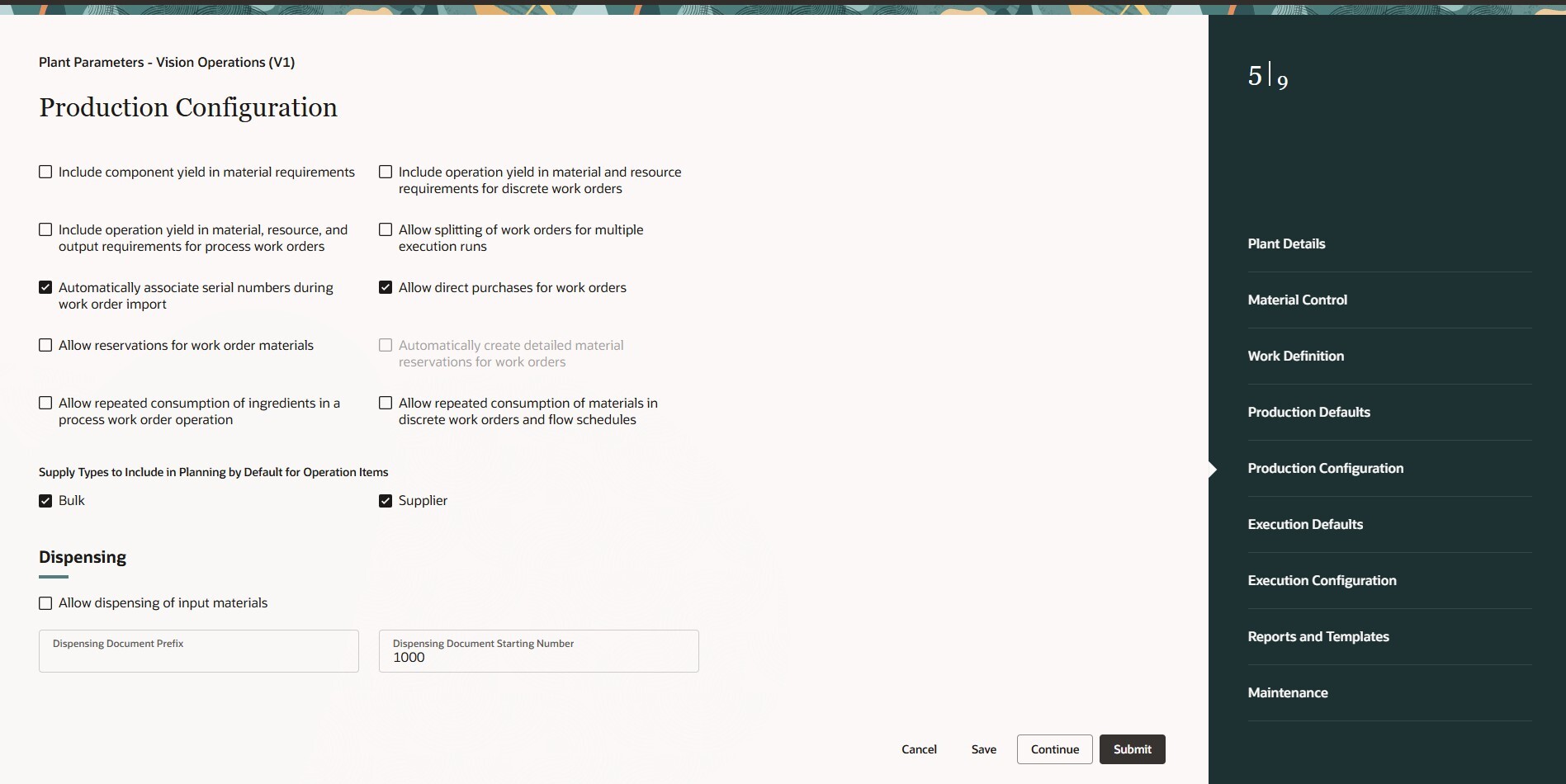

Plant Parameters: Production Configuration
This guided process helps users define plant parameters accurately and efficiently. It makes required definitions easy to find and navigate, providing step-by-step guidance that reduces complexity.
