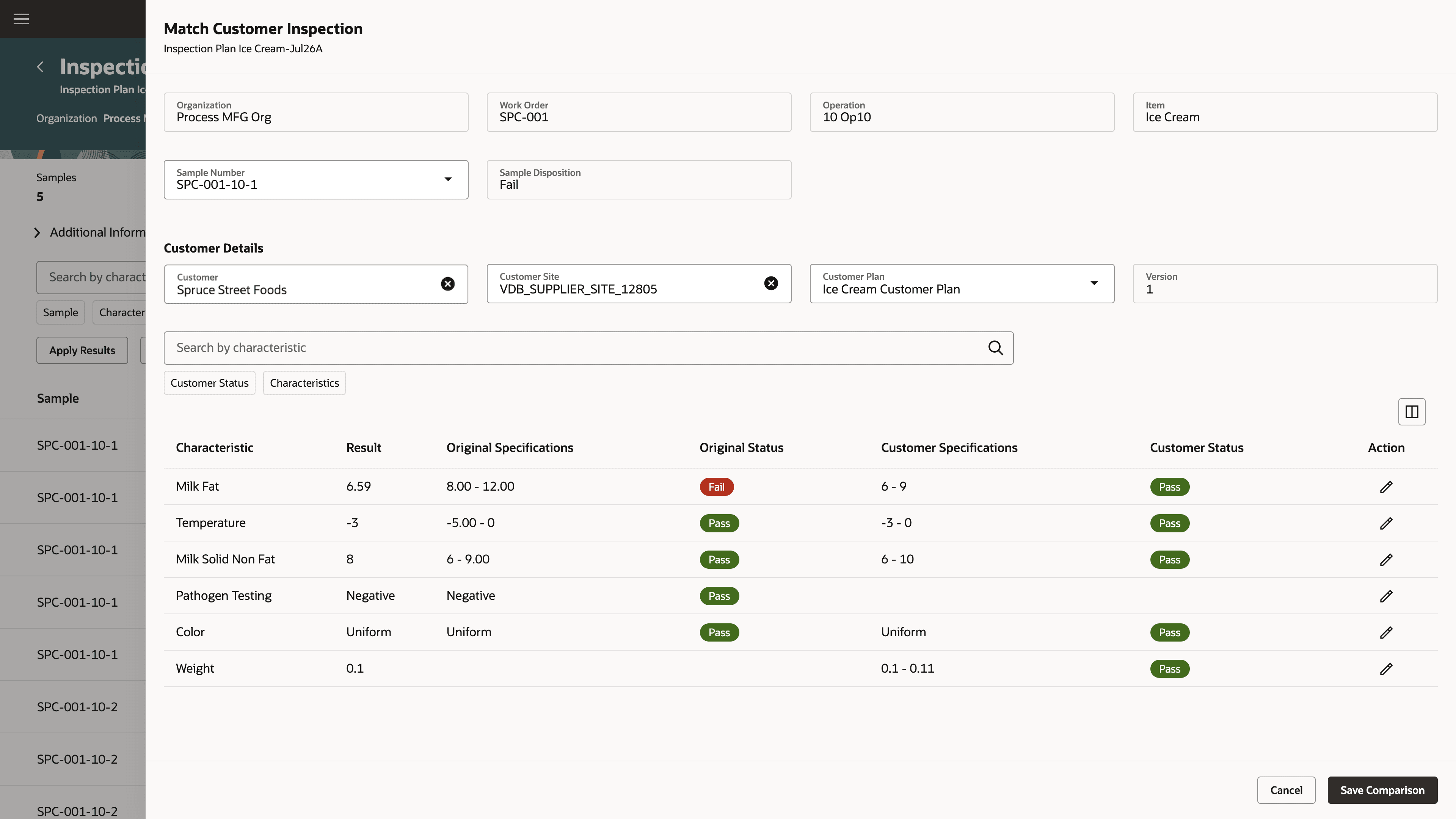

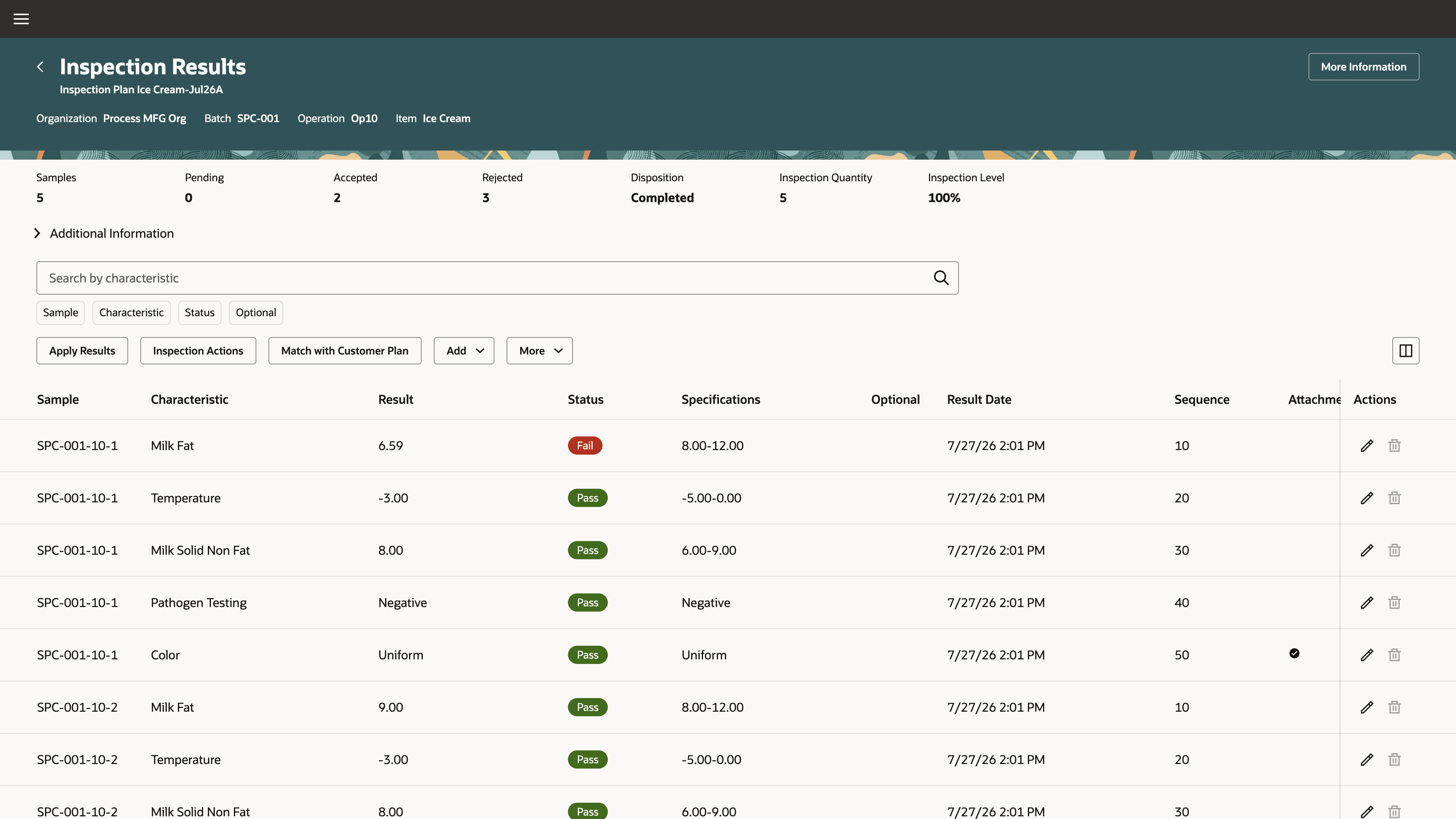

Customer inspection plans leverage in process and final inspections to evaluate whether the product meets conformance for a customer. You can search for and edit a work in process (WIP) or inventory inspection that has completed with a final disposition of Accepted, Rejected, or Completed, then use the Match with Customer Plan action to compare the inspection results against the customer inspection plan.
Original Inspection Results for Match with Customer Plan
In the unified view of the original WIP or inventory specifications and customer specifications, the selected sample or serial represents the final inspection results used as the basis for specification comparison and disposition. The existing inspection results are automatically evaluated as pass or fail against the selected customer inspection plan specifications. If the evaluation meets your requirements, you can save the results comparison.
Results Comparison between Original and Customer Specifications
If the customer inspection plan requires additional inspection characteristic results, you can enter those results against the selected sample to determine conformance. When the inspection fails to meet the specifications for a specific customer, you can select another customer inspection plan and repeat the results comparison to determine acceptability and record the disposition.

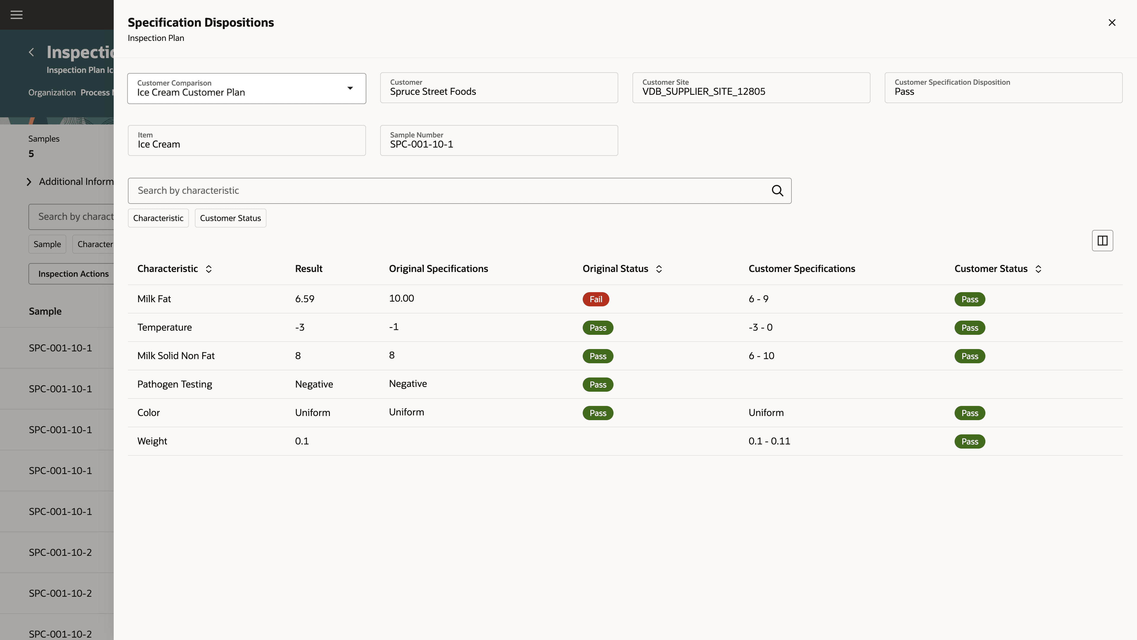

For traceability purposes, you can view the inspection and use the View Specification Dispositions action to see the results compared against different customer inspection plans.
View Customer Specification Dispositions for an Inspection

- From work in process or inventory inspection results with an Accepted, Rejected, or Completed status, start the customer specification comparison.
- Select the sample or serial when more than one is available, enter the customer and customer site, and select a matching customer inspection plan.
- Review the original results and specifications alongside the customer specifications. Enter any missing customer results as needed. You can't change any of the existing result values.
- Save the customer specification comparison if the results are satisfactory.
