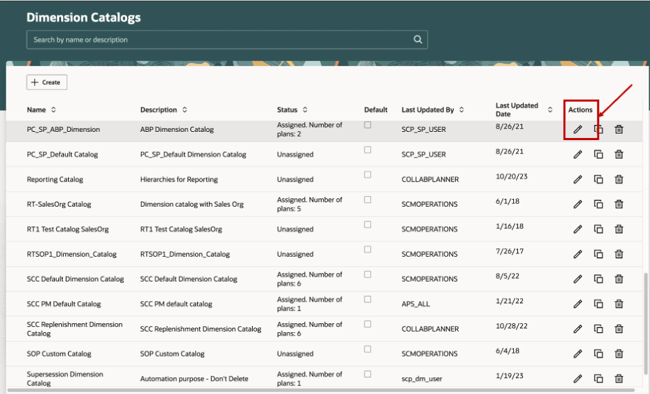

3. On the Dimension Catalogs page, select Edit.
Navigating to page search

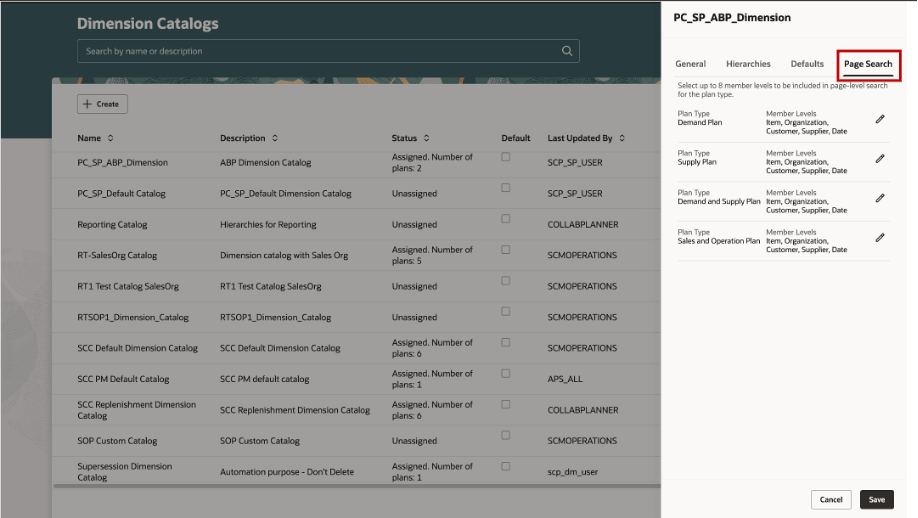

4. Select the Page Search tab.
Page search tab
Page search tab

5. Select Edit for any plan type.
A configuration drawer displays the eligible hierarchies and member levels that were previously selected on the Hierarchies tab.
Configure members to display in page-level search
