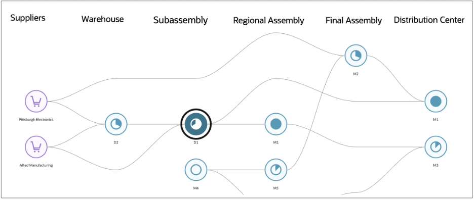

Echelon-based network structure
The Supply Chain Network is organized into multiple echelons (tiers), where each echelon represents a group of locations at the same level in the supply chain.
The leftmost echelon represents Supplier Sites when supplier visibility is enabled. Subsequent echelons contain downstream manufacturing, component, and distribution organizations, and the rightmost echelon contains the finished goods organizations associated with the selected items.
Each organization is assigned to an echelon by traversing the sourcing relationships defined in the plan. Shared organizations appear only once within an echelon, even when they participate in the supply chain for multiple items, providing a consolidated view of the network.
You can rename echelon headers using the Edit Properties action.
Editing the name of an echelon
Editing name of an echelon
The user-defined echelon names are displayed as column headers in the network visualization such as:
  • Suppliers
  • Parts Warehouse
  • Subassembly Manufacturing Units
  • Regional Manufacturing Units
  • Final Assembly Manufacturing Units
  • Distribution Centers

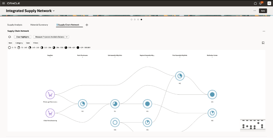

Default tiered layout in the Supply Chain Network
  • The network renders in a left-to-right, column-based hierarchy
  • By default, all echelons of the network are shown
  • Each echelon is displayed as a fixed vertical column
  • Nodes are aligned consistently within their respective echelons for readability
Node and arcs representation in the Supply Chain Network
The Supply Chain Network visualization is constructed from the relationships defined in the sourcing rules in the assignment set for the plan.
By default, the visualization shows all the inventory organizations in the plan as nodes organized in different echelons. When you search for a specific segment or category, the nodes in the first level on the right will be limited based on the search filters. All upstream nodes to the left are then displayed based on the sourcing relationships for those end items. The arcs capture the full breadth of manufacturing, procurement, and transfer relationships across all components of an end item (for example, the keyboard, display, and battery for a laptop), with the nodes representing the organizations.

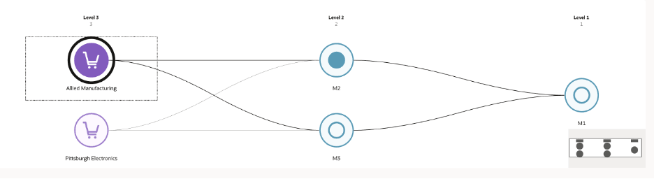

Example: Analyze upstream and downstream supply relationships
Illustration of upstream and downstream supply relationships for a selected organization
Consider that you search for a finished good using the Item filter. The Supply Chain Network first identifies the organizations associated with the searched item at the end of the supply chain and then uses the sourcing relationships defined in the plan to construct the network of organizations that contribute to supplying that item.
The network is rendered with the end-of-chain organization in Level 1 on the right. Moving from right to left, Level 2 contains the organizations that supply the Level 1 organization, and Level 3 contains organizations further upstream in the sourcing chain. If additional sourcing levels exist for the searched item and its components, they're displayed as additional echelons to the left.
The nodes represent organizations, not individual items. Therefore, an organization displayed in an upstream echelon can contain many items. It's included in the network because the sourcing relationships for the searched finished good and its components establish a supply relationship through that organization.

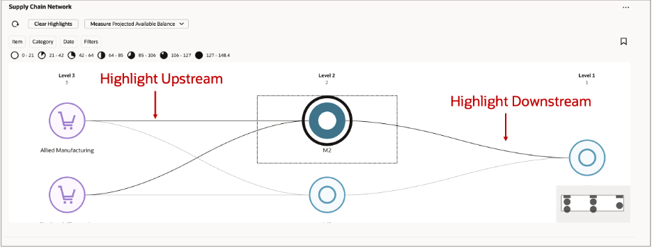

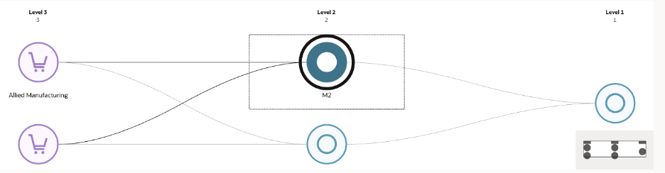

After the network is rendered, you can select an organization to investigate its supply relationships. In this example, M2 in Level 2 is selected.
Select Highlight Upstream to trace the organizations that directly or indirectly supply M2. The applicable sourcing arcs and organization nodes to the left of M2 are highlighted, so that you can identify the upstream organizations on which M2 depends.
Select Highlight Downstream to trace the organizations that M2 directly or indirectly supplies. The applicable sourcing arcs and organization nodes to the right of M2 are highlighted, so that you can follow the material flow from M2 toward the organization at the end of the supply chain.
Nodes and arcs that aren't part of the selected upstream or downstream path are faded into the background. You can start with the finished good specified in your search criteria and then progressively investigate the organizations and sourcing relationships that contribute to its supply across multiple echelons.

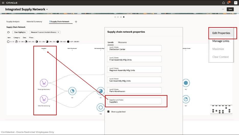

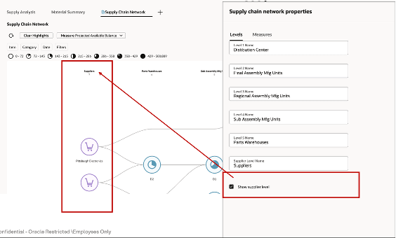

Show or hide the supplier level
The Supply Chain Network visualization can optionally include a Supplier echelon, enabling you to extend the network beyond inventory organizations to include supplier sites and their sourcing relationships.
You can control the visibility of the Supplier echelon from the Edit Properties dialog box. Select Edit Properties from the visualization toolbar, and then select or deselect the Show supplier level option on the Levels tab.
Show supplier level
Show supplier level
When Show supplier level is selected, the visualization adds a new Supplier echelon as the leftmost column in the network. Supplier site nodes are rendered for all supplier sites that have sourcing relationships with the organizations currently displayed in the network. Directed arcs connect each supplier site to its downstream organization, extending the network to show the complete upstream supply chain.
Supplier site nodes support the same interactive capabilities as organization nodes. You can hover over a supplier node to view supplier-specific measures, highlight upstream or downstream sourcing paths, and drill to related planning information. Supplier nodes display supplier capacity measures, including Supplier Capacity Available, Supplier Capacity Required, and Supplier Capacity Utilization, allowing you to analyze supplier constraints together with the rest of the supply network.
When Show supplier level is deselected, the Supplier echelon and its associated sourcing relationships are removed from the visualization. The remaining organization echelons retain their layout and relationships, providing an organization-only view of the supply chain.

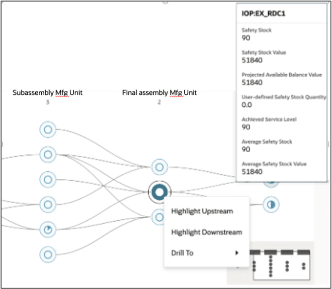

On hovering over nodes, a tooltip panel appears adjacent to the node, showing the measure values for that organization such as Projected Available Balance, Projected Available Balance Value, Planned Orders, Total Demand, and Demand At Risk Value.
Tooltip panel when hovering on a node
Tooltip when hovering on a node
When you right-click on a given node, a context menu appears with three options, Highlight Upstream, Highlight Downstream, and Drill To.
Context menu options
You can choose to highlight upstream or downstream. Selecting Highlight Upstream traces all sourcing relationships flowing left from the selected node, that is, all organizations that directly or indirectly supply the selected node.
Highlighting upstream
In the preceding image, highlighting upstream for the selected node (M2) would emphasize all connected nodes in the immediate left and any further echelons to the left, along with the arcs connecting them to the selected node. Only organizations that have a direct sourcing arc leading into M2 are highlighted, not every node in those echelons.
Selecting Highlight Downstream traces all sourcing relationships flowing right from the selected node, that is, all organizations that the selected node supplies to. For Allied Manufacturing in the following image, highlighting downstream emphasizes the connected nodes in the rightmost echelons and the arcs leading to them.
Highlighting downstream
Related arcs are emphasized, while unrelated nodes and arcs are visually faded. You need to refresh the network view to clear the highlights.

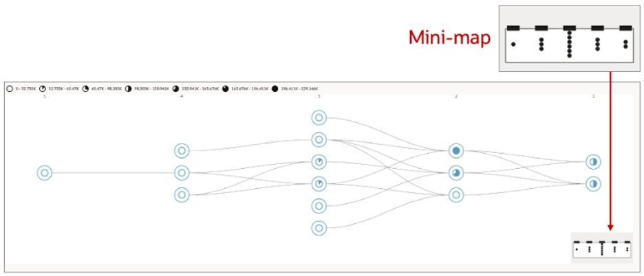

Zooming and mini-map guidance
The Supply Chain Network visualization supports a continuous zoom range between a minimum (fit-to-screen) and a maximum zoom level. The following two screenshots represent the two extremes of this range. All intermediate zoom levels are available via scroll wheel, pinch gesture, or the zoom control panel.
Default view zoom(fit-to-screen)
Default zoom level view
At the default (minimum) zoom level, the entire network is scaled to fit within the available canvas. At this level:
  • All nodes are visible simultaneously, rendered at their smallest size.
  • Node labels are hidden to prevent overlap. The pie-chart fill within each node indicates the relative measure value.
  • Arcs are visible as thin curved lines connecting nodes across supply chain tiers.
  • Tier echelon column headers remain visible along the top of the visualization.
  • The mini-map viewport indicator covers the entire mini-map because the full network and the canvas view are coextensive at this level.

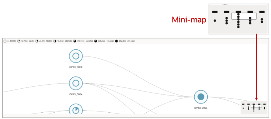

Maximum zoom
Maximum zoom level view
At the maximum zoom level, a small subset of nodes fills the canvas. At this level:
  • Nodes are rendered at full size with their labels fully visible beneath each node. For example, Suppliers echelon shows S1 as a supplier site node, or Manufacturing Assembly echelon shows M1 and a manufacturing org node.
  • The pie-chart fill within each node icon is more prominent for measure value clearer for individual nodes.
  • Only a small number of nodes are within the viewport and the rest of the network is off screen.
  • The mini-map viewport indicator shrinks to a small rectangle, reflecting the narrow slice of the network currently in view. This rectangle moves in real time as you zoom in and out of the network visualization.

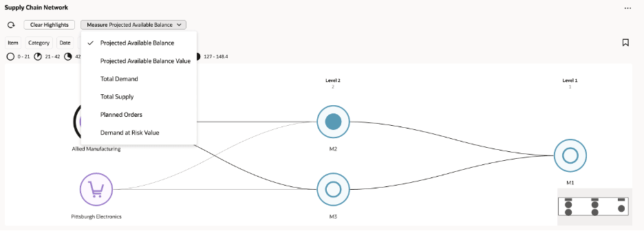

Measure selection in Supply Chain Network
Measure drop-down list
The Supply Chain Network visualization is driven by a selected measure, which determines the color gradation used for rendering the nodes.
Use the Measure drop-down list on the toolbar to select the planning measure displayed on the Supply Chain Network visualization. The selected measure determines the values shown on each node and the corresponding node fill, and you can compare relative measure values across the network.
Changing the selected measure refreshes the visualization, updating the node values, color distribution, and hover tooltips while preserving the current network layout, search filters, and highlighting.

You can select the measure to analyze from the Measure drop-down list on the visualization toolbar.
By default, the following measures are available for selection in a supply plan:
  • Projected Available Balance
  • Projected Available Balance Value
  • Total Demand
  • Total Supply
  • Planned Orders
  • Demand at Risk Value

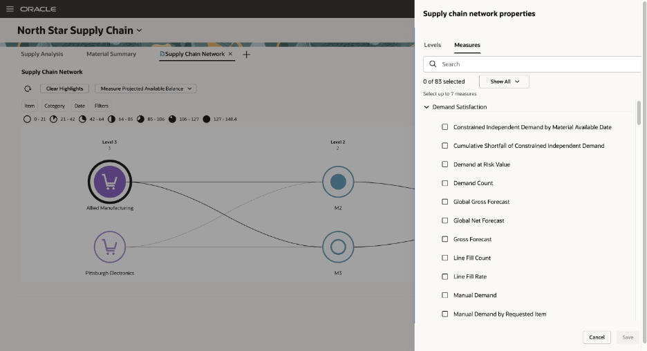

You can change the measures available in the Measure list using Edit Properties for the Supply Chain Network visualization.
Select the Edit Properties option from the visualization’s menu, and then select the Measures tab.
The Measures tab displays the Supply Chain Planning measures that are available for use with the visualization, organized by measure group. You can search for a measure or browse the available measure groups and select the measures that you want planners to use when analyzing the network.
Measures tab in the Edit Properties drawer
You can select up to seven measures. Your selection isn't limited to the measures provided by default. You can select other applicable Supply Chain Planning measures, including measures that you've created, and make them available directly from the Measures list.
After you save the visualization properties, the measures you selected replace the default selection in the Measures list. You can then switch between these measures directly from the toolbar without returning to Edit Properties.
When you select a measure from the toolbar, the Supply Chain Network refreshes the measure information displayed for the network. The node fill and the value ranges in the legend are recalculated based on the selected measure, enabling you to visually compare the measure values across organizations in different echelons of the supply chain.
This measure configuration gives you the flexibility to tailor the Supply Chain Network to the planning metrics that are most relevant to your business and use the same network visualization to analyze both predefined measures and planning measures you’ve created.
