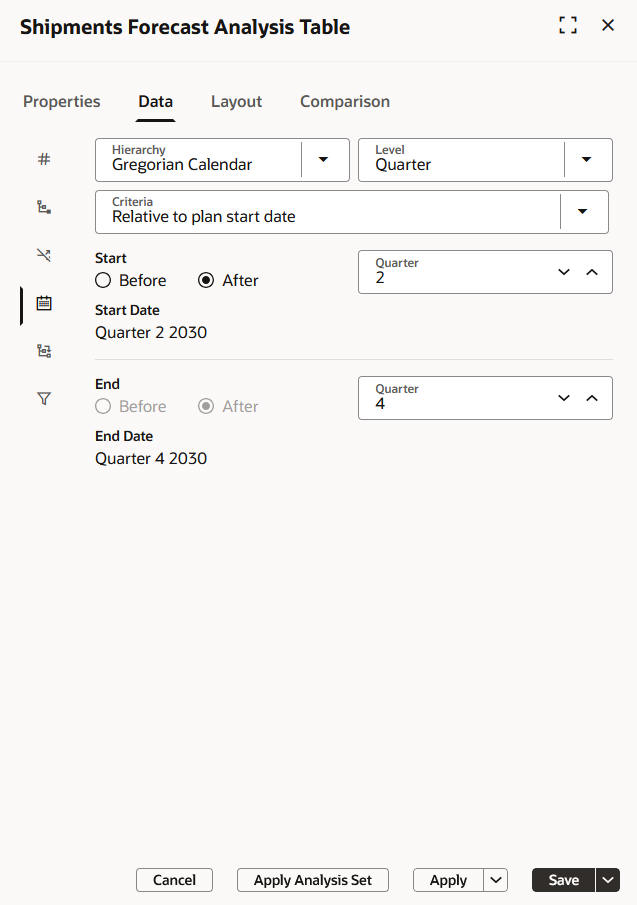

If you wanted the visualization to display data starting 2 quarters after the plan start date and ending 4 quarters after the plan start date, you would make the selections in the following screenshot:
Selections for time range starting and ending after plan start date

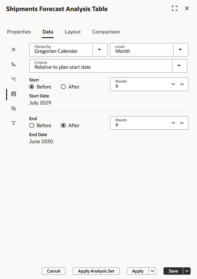

In Update 26D, when you open visualizations that were created in previous updates and use the Relative to plan start date or Relative to today criteria, Before is automatically selected in the Start section, and After is automatically selected in the End section.

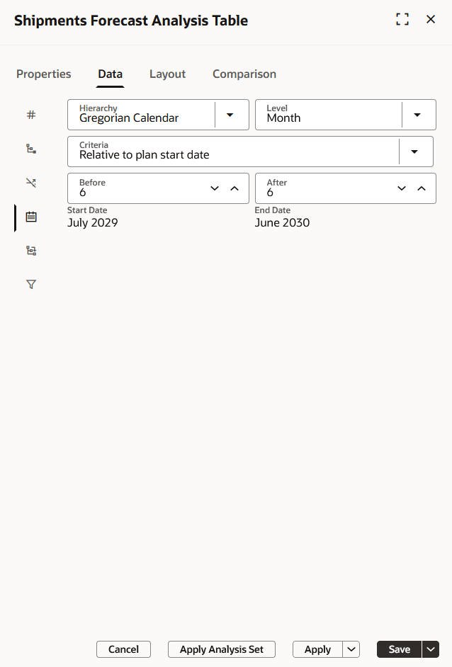

For example, the following screenshot shows the selections for an existing visualization before Update 26D:
Selections for existing visualization in Update 26D
Selections for existing visualization before Update 26D
The following screenshot shows the selections for the visualization in Update 26D:
