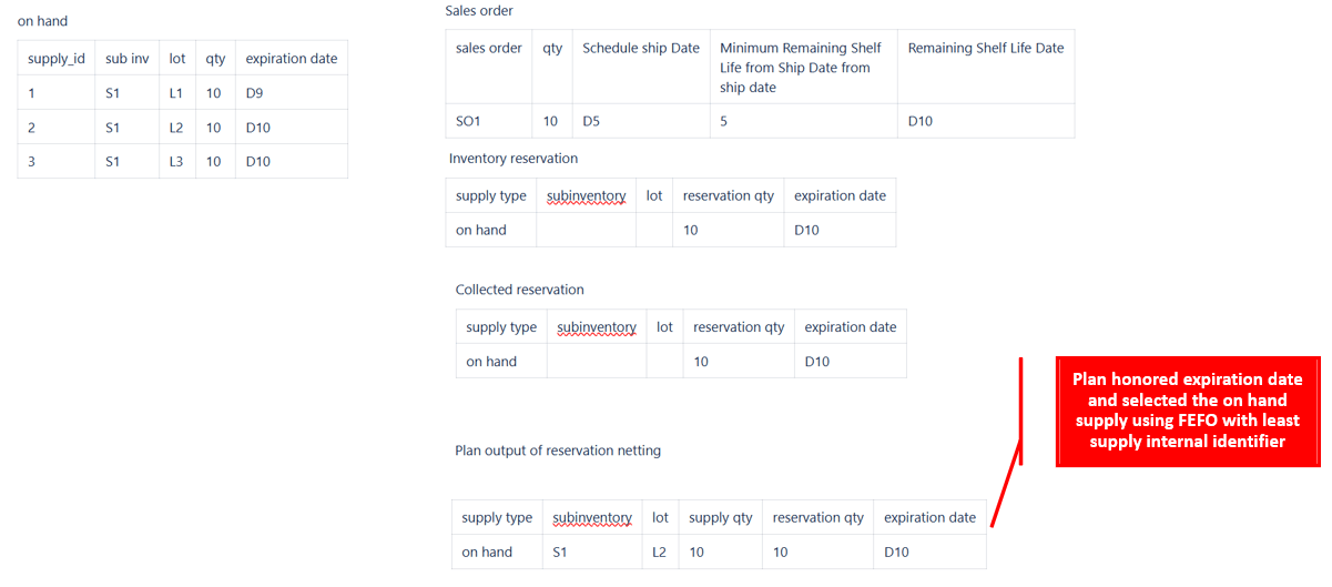

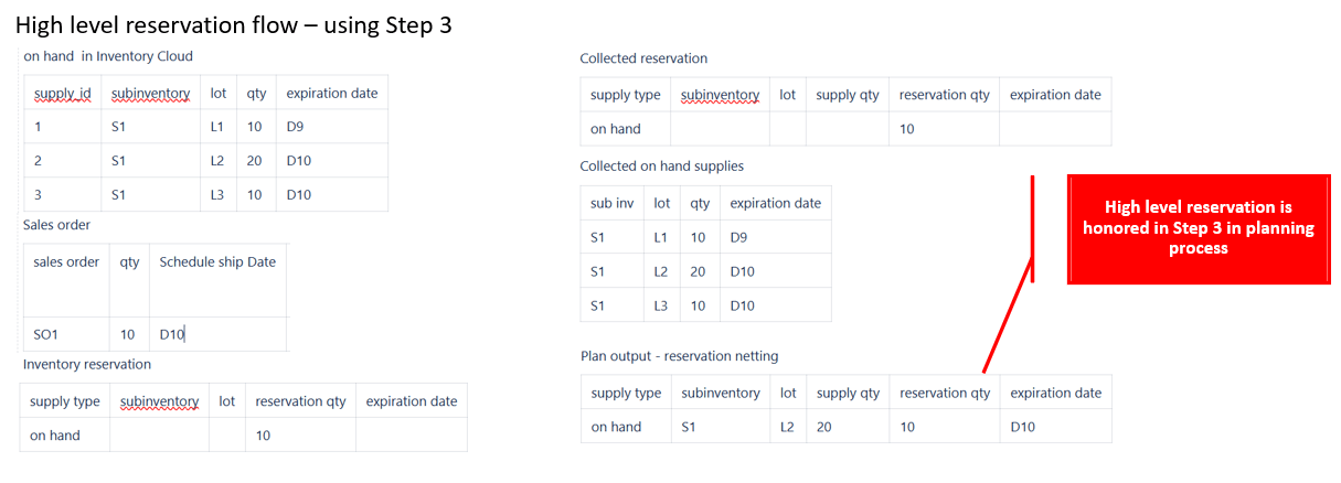

Example Plan 1 – High- level reservation – uses Step 3
Note: The Specify Minimum Shelf-Life Controls for Perishable Items opt-in is enabled.
Plan output respecting high-level reservation

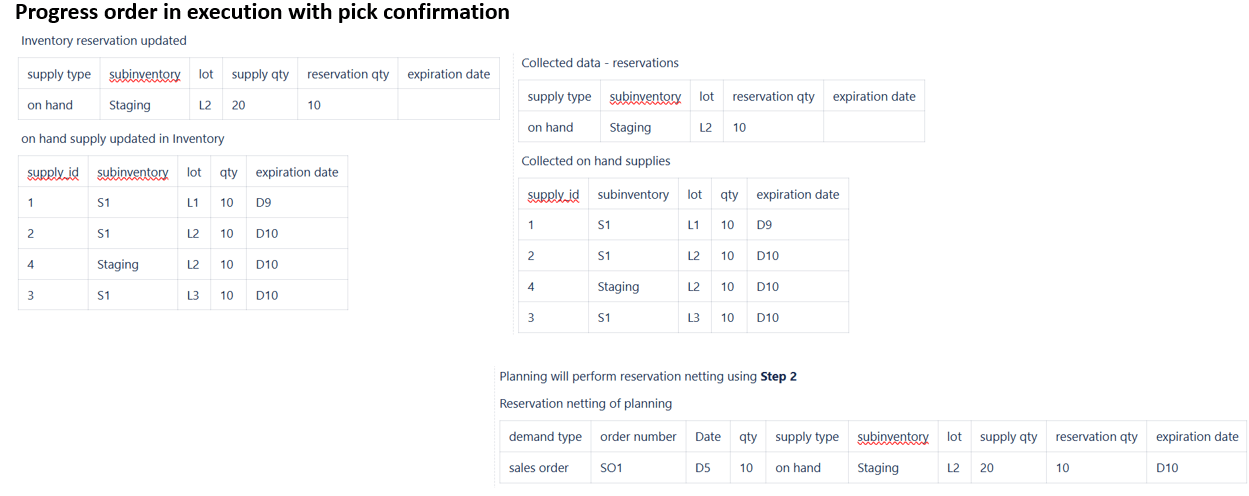

Pick-confirmed reservation respected for lot-controlled items

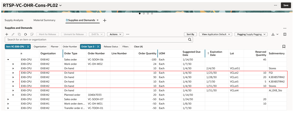

Example Plan 3  – Viewing enhanced reservation information in Supply Planning

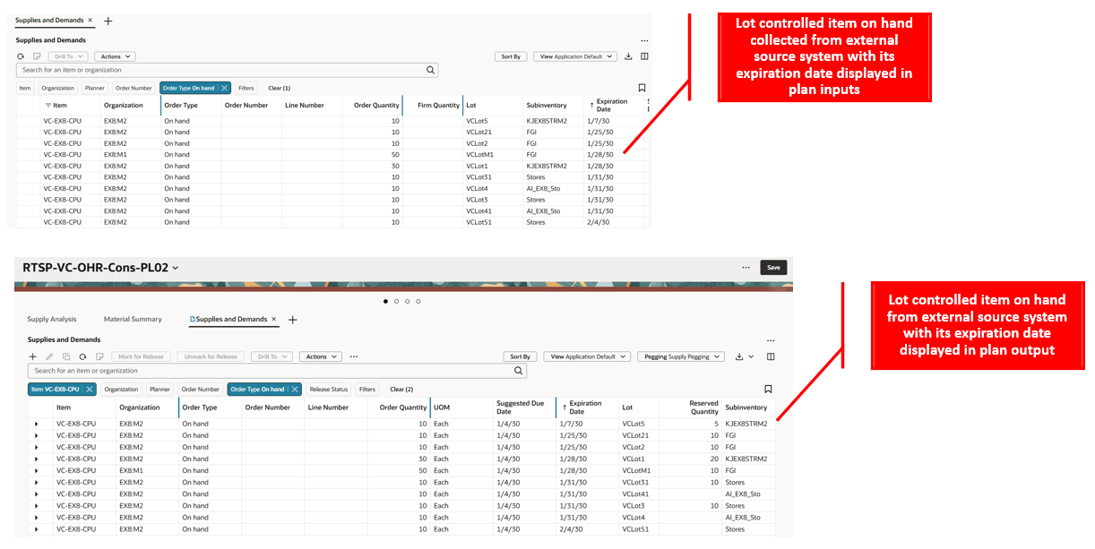

Collected on hand planned with reserved quantity in supply plan
Reservation pegging output of a sales order and on-hand supplies in supply plan

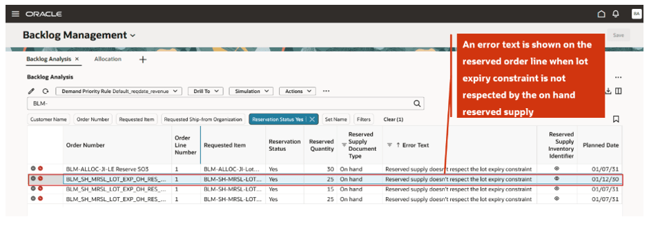

For reserved order lines, if the underlying reserved supply doesn’t respect the lot expiry constraint, then the same supply is still used to plan the sales order line. An error text is shown on the order line to inform the user about the issue. Also, such order lines are eligible for release to the Order Management system. To see the details of the reserved supply, select the icon in the Reserved Supply Inventory Identifier field.
Error text shown on violation of lot expiry constraint for reserved order lines

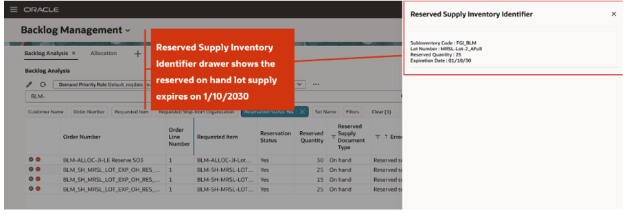

Notice that in this example, the reserved on-hand lot supply expires on January 10, 2030, which is before the planned date of January 12, 2030 for this order line.
Reserved Supply Inventory Identifier drawer

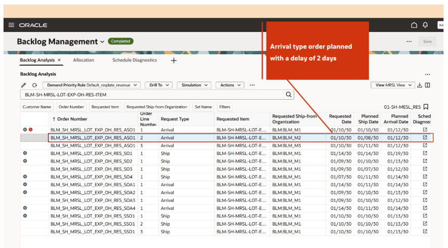

The highlighted order line is planned on January 12, 2030.
Arrival type order planned by respecting lot expiry

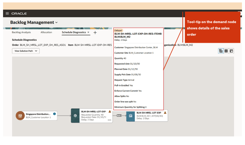

Let’s navigate to the scheduling diagnostic for this order line to understand the diagnostics details for this order line. Notice the tooltip on the demand node shows a Requested Quantity of 40 planned on January 12, 2030.
Tooltip on demand node

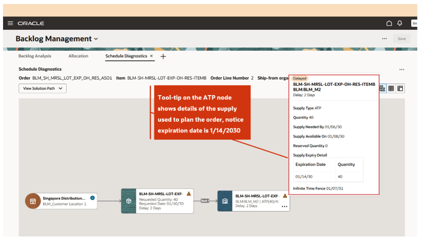

Let’s review the ATP node. The tooltip on the ATP node shows Requested Quantity of 40 units is planned on January 12, 2030 with ATP supply that has an expiration date after the planned date or January 14, 2030.
Tooltip on ATP node
Tooltip on ATP node
