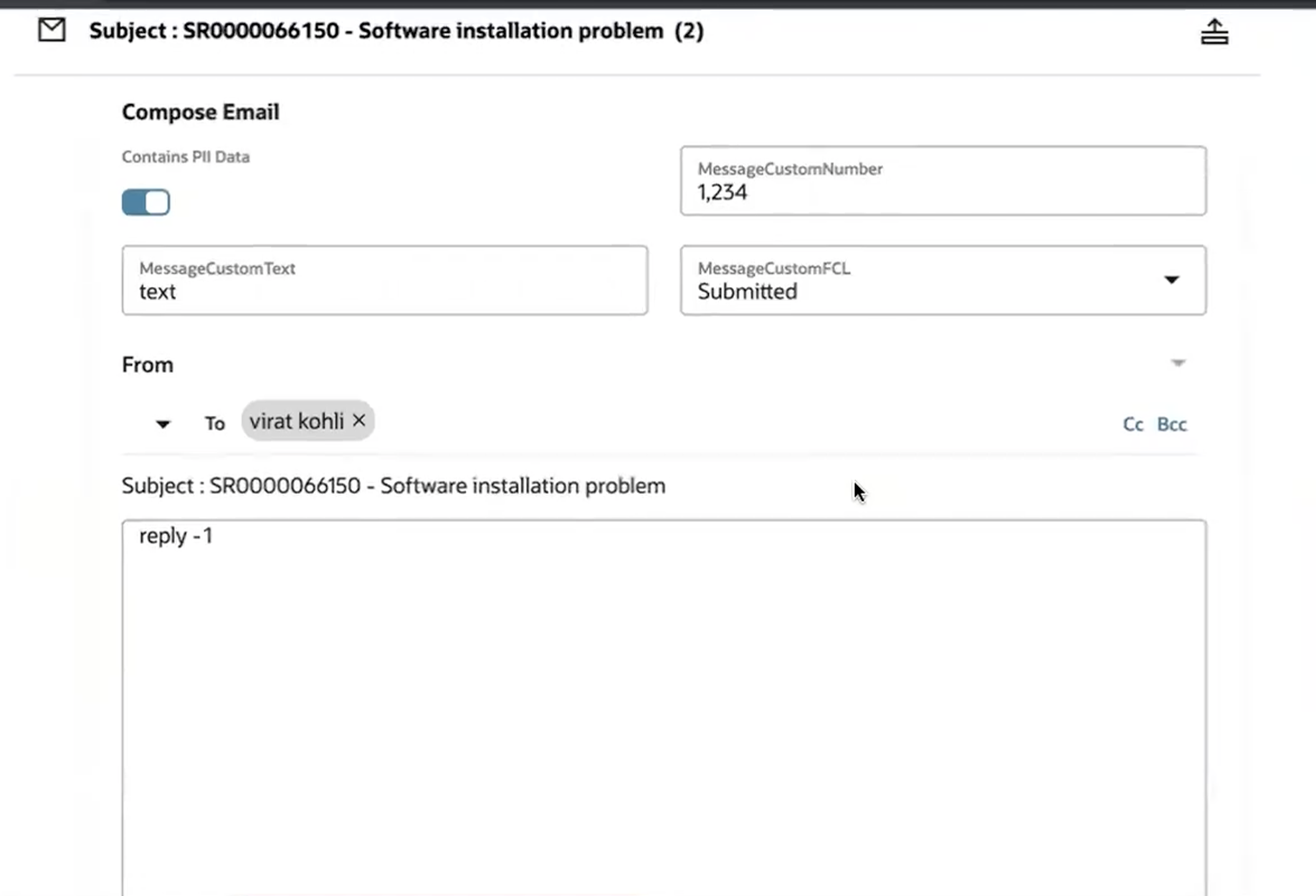

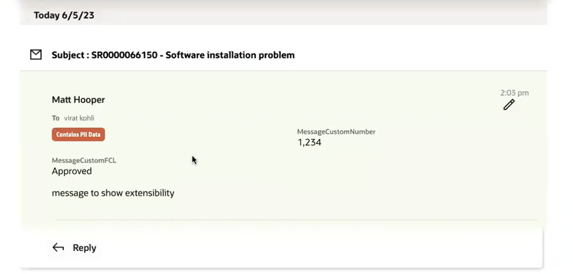

The prebuilt layouts for SR messages for each message type (Customer Entry, Internal Note and Response) can be extended to display additional fields. In Visual Builder Studio, you can clone the six seeded layouts for messages and then add additional fields like Contains PII Data, and Message Subtype, as well as custom fields. Using these fields, your organization has the ability to add additional data and classification information to help with the review and triage of information. You can also use the PII field to indicate any messages that contain PII data. Users with the correct privileges can then edit these messages to remove or redact confidential data so that you can maintain compliance with privacy regulations such as GDPR.
Compose SR Message layout with the PII Data field, Message subtype and a custom field exposed
Show SR Message layout with the PII Data field, Message subtype and a custom field displayed
Frequently SR messages need to be modified to fix typos and errors or to just tag them as containing sensitive PII information. In previous releases, there was no mechanism to modify the attributes of a message after it has been posted. This enhancement enables your administrator to grant the ability to modify posted SR messages and thus improve the quality of the data.

  1. Configure the fields such as Contains PII Data, Message Subtype and custom fields to be displayed in the Service Request Activity Stream.
  2. Using Visual Builder, extend the message layouts for compose and read only templates to add these fields to the various message types.
