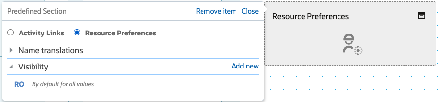

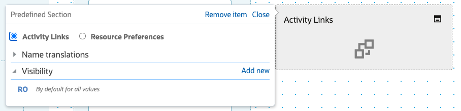

Screen Configuration

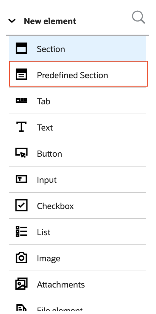

This feature introduces a new element 'Predefined Section' which can be added to the elements panel in the 'Edit/View Activity' screen configuration.
Similar to how a new section is added, this new element can be added by dragging and dropping it in the desired place in the activity screen context. When adding the Predefined Section into the main screen, users can either select 'Activity Links' or 'Resource Preferences'. If translations are enabled in your environment, they will be auto populated and can be changed as needed.
Each type of predefined section can be independently set as Read-Only or Read-Write. Users with a Read-Only permission will only be able to view the Activity Links or Resource Preferences details. Users with a Read-Write permission will be able to view and modify the Activity Links or Resource Preferences details.

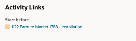

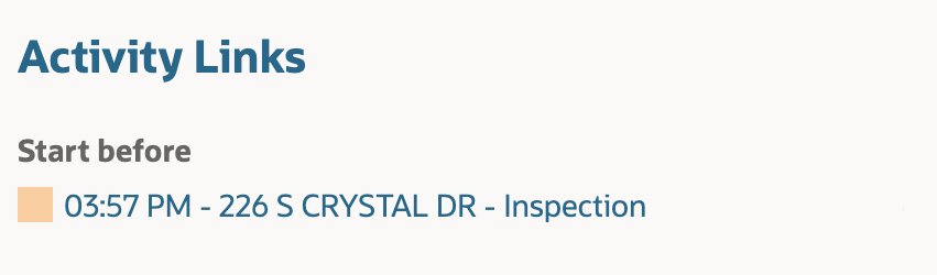

If the linked activity is assigned to the same user or to a resource who is visible to the user, the identifiers of the linked activities will serve as a link that, when clicked on, will display the details of the corresponding activity. In offline mode, for the resource to whom the activity is assigned, the identifier will be a link only if the linked activity is also assigned to the same resource. In other cases, the activity identifier will be displayed just as a text in black. The color of the square before the identifier will be based on the status of the activity, using a similar color coding convention from the Activity Type configuration.

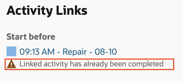

If the condition of the link is violated, a warning message will be displayed below the linked activity.
Warnings will be displayed in various circumstances, such as:
- If the link is Start-to-start and the second activity has already started when the first activity hasn't yet been started.
- If the link is Start-to-start or Finish-to-start, and the first activity has been canceled.
- If the link is Finish-to-start and the second activity has already started when the first activity hasn't yet been completed.
- If the activities are scheduled in a way that the link condition may not be met. E.g. if the first activity has been scheduled to start after the second activity.
- If the activities are supposed to start simultaneously but there is a gap of more than one hour between their scheduled start time.
- If the activities are supposed to start simultaneously and only one of them has started while the other hasn't started.

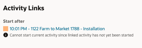

In addition to warnings, the system will also display certain informational text if the current activity cannot be started until an action has been taken on the linked activity. This will inform the technician that the current activity cannot be started yet.
Such information will be displayed in cases such as:
- If the link is Start-to-start and the first activity hasn't started yet.
- If the link is Finish-to-start and the first activity hasn't been completed yet.

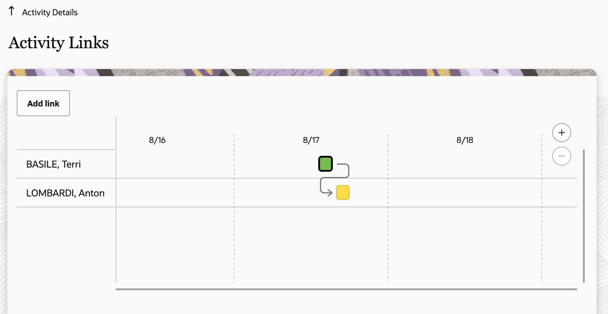

If the 'Activity Links' predefined section is added with the visibility condition as Read-Write, the section will be displayed very similarly to how it is displayed for Read-Only; the only difference is that the title of the section will be a link (in blue color).
Clicking on the 'Activity Links' title will take users to the existing activity links screen, where they can add new activity links or modify existing ones, similar to the current functionality.

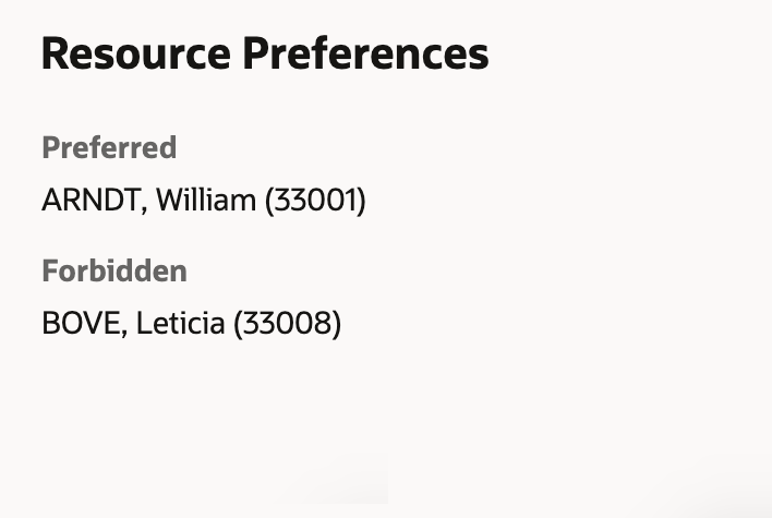

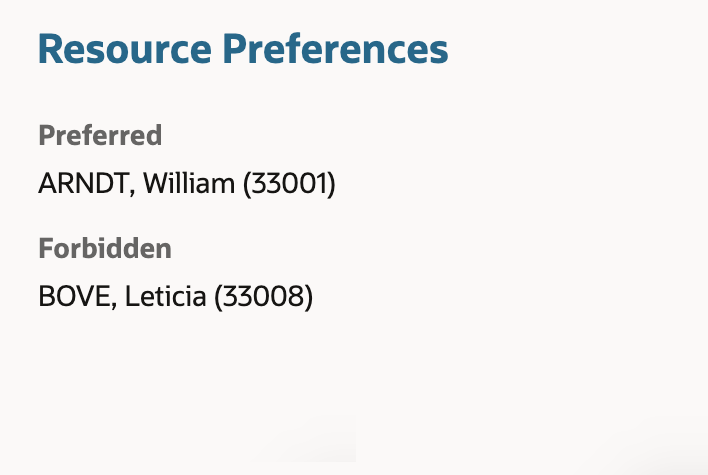

Similar to 'Activity Links', if the 'Resource Preferences' predefined section has been added to the activity details screen configuration, a new section 'Resource Preferences' will be displayed in the main activity details screen. If the predefined section was set as Read-Only, the section will be Read-Only. This section will include all the resource preferences set for the activity grouped by Required, Preferred and Forbidden.
If the 'Resource Preferences' predefined section is added with the visibility condition as Read-Write, the section will be displayed very similarly to how it is displayed for Read-Only; the only difference is that the title of the section will be a link (in blue color).

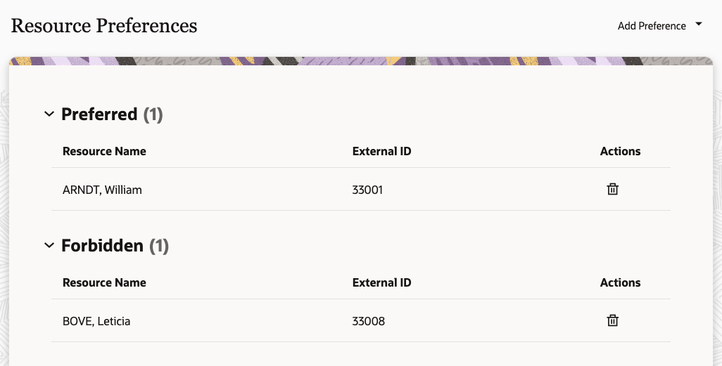

Clicking on the 'Resource Preferences' title will take users to the existing Resource Preferences screen, where they can add preferences or modify existing ones, similar to the current functionality.

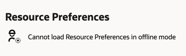

In offline mode, the link to the existing Resource Preference screen will not be clickable and will be displayed in black as a normal heading. The data for resource preferences may not be available in offline mode and therefore the predefined section may not display the resource preference details.
