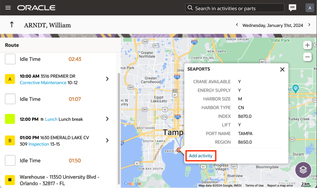

- Button of Map Layer hint
- Column 'Plugin/Form Field'. The value of this property is passed to an opened Plugin/Form.

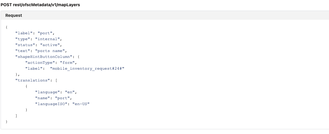

Example of requests:
GET /rest/ofscMetadata/v1/mapLayers/{label}
Example for response with added fields:
Response Collapse source

"shapeHintButtonColumn": {
"actionType": "form",
"label": "mobile_inventory_request#24#"
