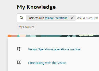

With this feature enabled and all of the necessary Business Unit setup completed, your authors will be able to assign a Business Unit to an article. Additionally, mass updating articles to move them between Business Units (or from having none) will be possible. Once your articles are connected to Business Units users will be able to filter their articles in My Knowledge with the Redwood User Experience (Service and HR Helpdesk) to any of that user's assigned Business Units. Digital Customer Service (DCS) is also releasing support for this feature in 24C, extending their existing Business Unit support to cover knowledge.

In UIs, such as DCS, where a BU has been predetermined, the knowledge presented will be filtered to that specific BU, making it simpler for your users to locate the answers most relevant to them. In the future, more UIs will be available that offer this functionality as well, such as determining the BU based on a selected Service Request.
