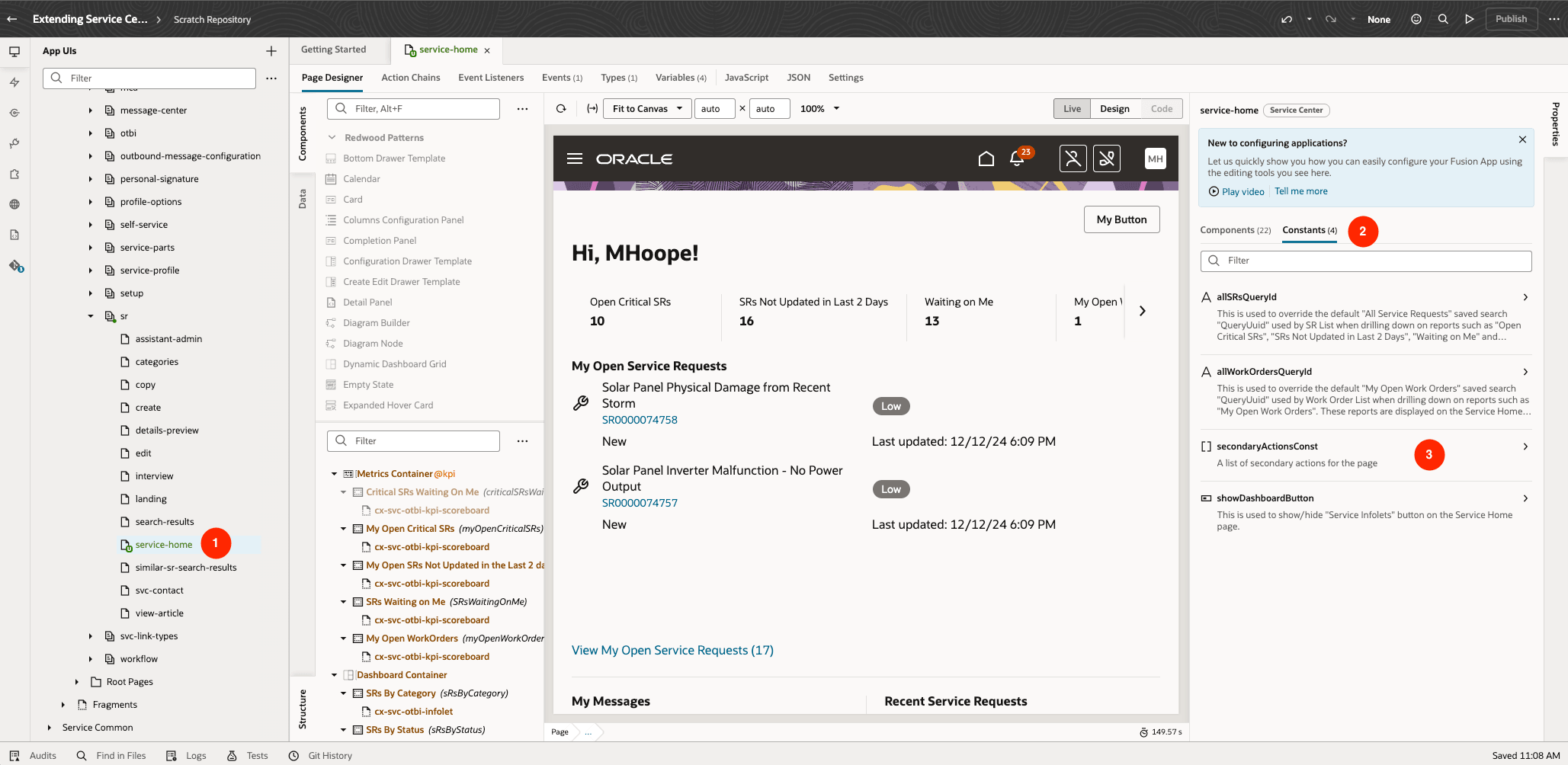

- Go to Oracle Visual Builder Studio and Navigate to "service/ec/sr/service-home";
- then, navigate to the page property panel and click to the sub-tab "Constants".
- Choose "secondaryActionsConst" which will lead to the specifics of the variable.

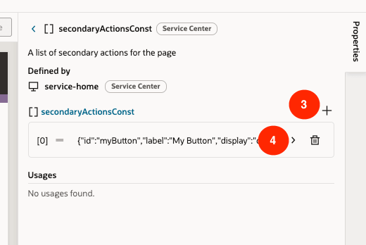

- Click the + icon to create a fresh set of buttons; when building a new set of buttons it replaces the standard set of buttons and does not add to the standard. Should you wish to have one of the standards one, we must design as part of your new set of buttons.

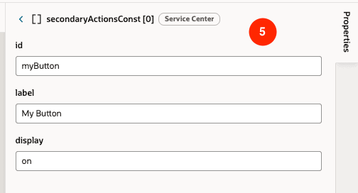

- Click on > icon on the array to supply specifics.
- Id this is the button's id, which we will use subsequently to listen to the click event
- Label of the button is this.
- Display: Pass on and off depending on your criteria to show or hide the button only conditionally.
