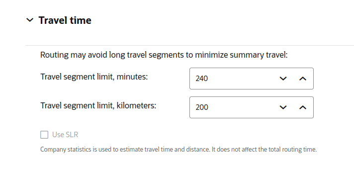

Routing Plan
- Within a routing plan configuration, the Travel segment limit, minutes and Travel segment limit, kilometers/miles fields can now be set even if SLR travel is not enabled for the routing plan.
- If no value is specified for these fields, the default values of 240 min and 200 km will apply. These are the same values previously used by the routing engine, ensuring there is no impact on routing results.
