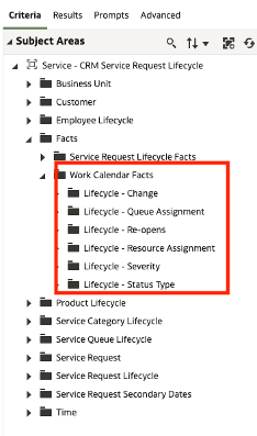

  • Out-of-box metrics added to the Service – CRM Service Request Lifecycle subject area
  • Pre-built reports are available at: shared/Service/Embedded Content/Customer Service Manager/Service Request Lifecycle Analysis/Work Calendar Based Reports

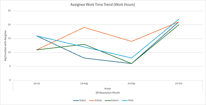

Out-of-box metrics based on your organization's work calendar
Avg Duration in work hours an SR was with assignee before resolution
Provide a more accurate picture of agent and service delivery performance by factoring agent non-working hours, company holidays and week ends.

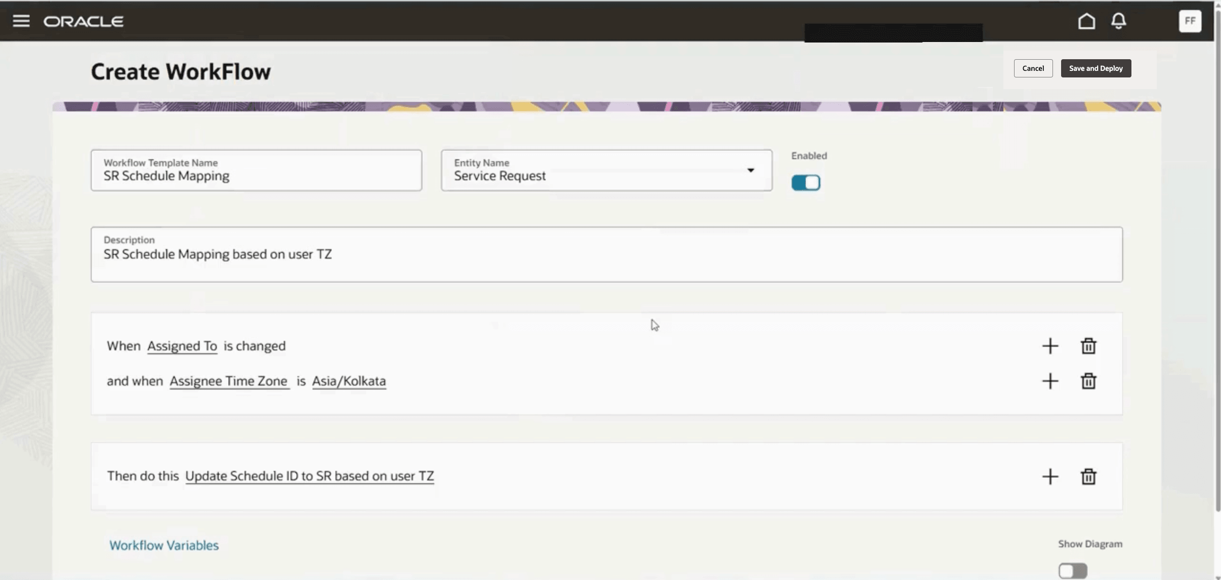

2. Attach the work schedules(s) created in Step 1 to SR using Workflow in Fusion Service.
    Go to Service Center -> Service Center Administration -> Productivity -> Create/Manage Workflows
    Workflow UI provides a flexible way to attach the schedules you create, based on your business requirements. For example, your service reps might be distributed across time zones.
    You could create a schedule for each time zone and attach them via workflow.
Create a workflows to attach a schedule to service request
Create a workflow to attach a schedule to service request
