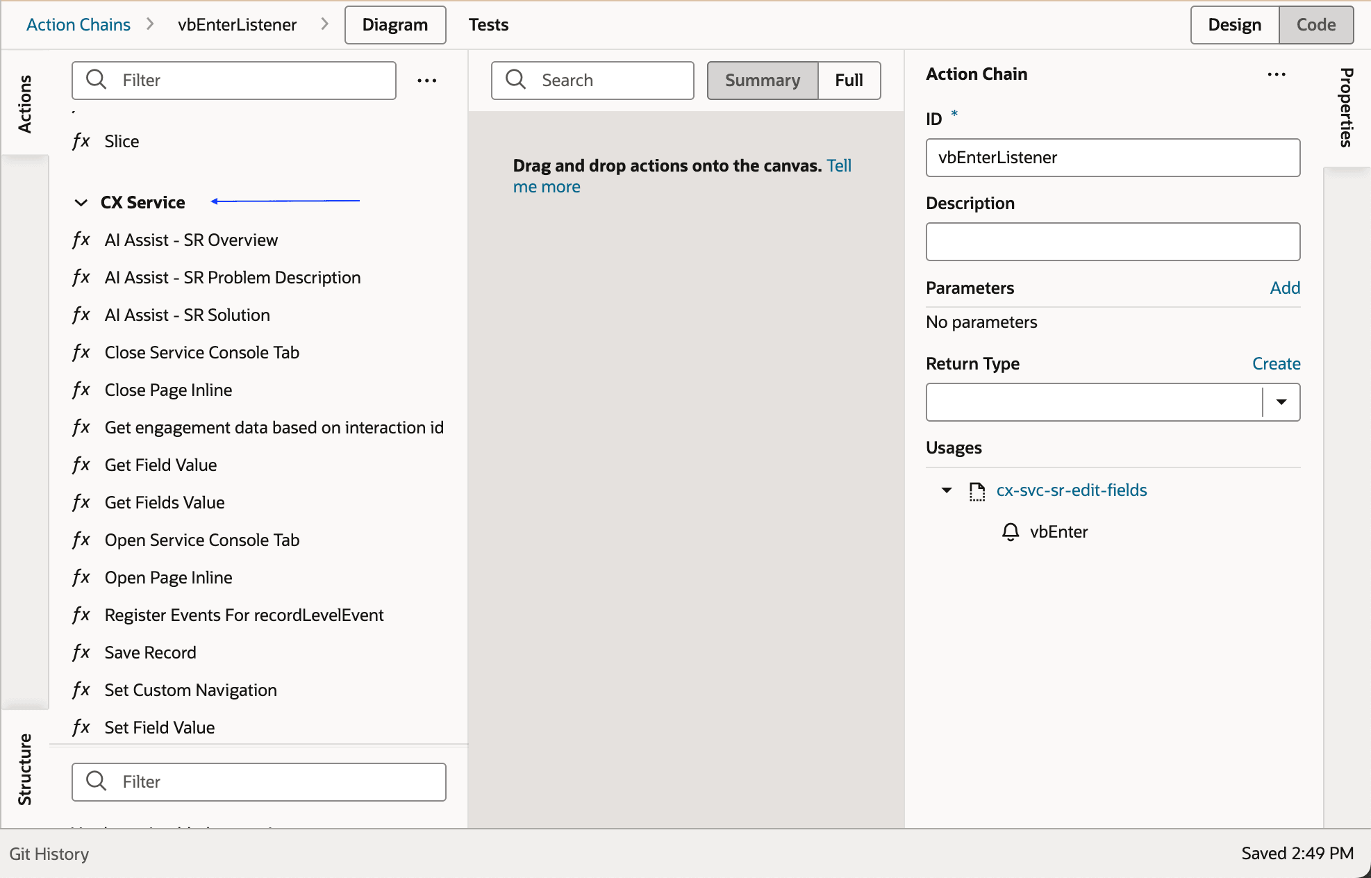

- Create an Action Chain Using Oracle Visual Builder Studio to extend Fusion Service Center
- From the Action Pallet, search for CX Service to find all CX Service Action related
We have three AI features currently available in the CX-Service Actions, which are labelled as below,
AI Assist - SR Problem Description:
This CX Action will make a request to the SR Problem Description AI Assist. The text generated is limited based on the standard field limitation. -
AI Assist - SR Solution:
This CX Action will make a request to the SR Solution AI Assist. The text generated is limited based on the standard field limitation. -
AI Assist - SR Overview:
This CX Action will make a request to the SR Overview.

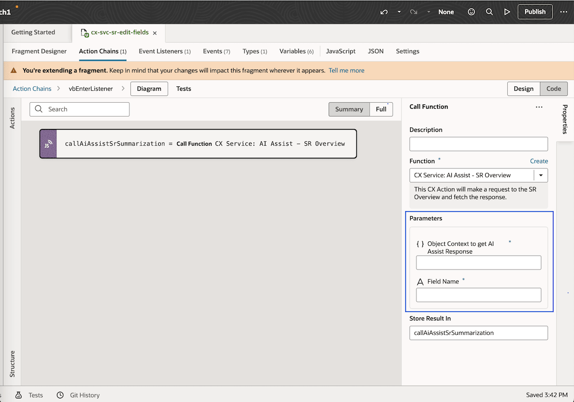

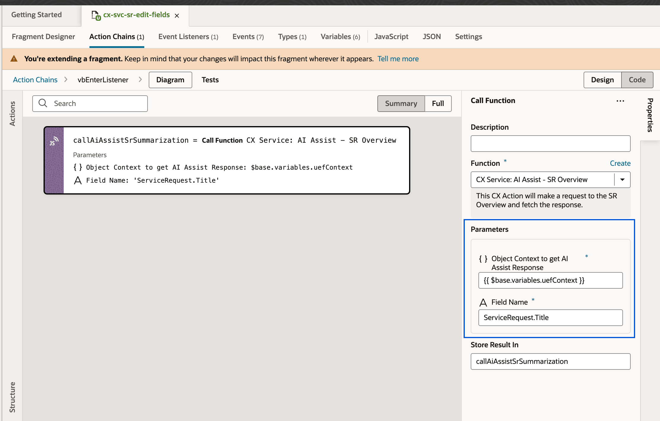

All the above 3 actions accepts two parameters as given in the below screenshots,

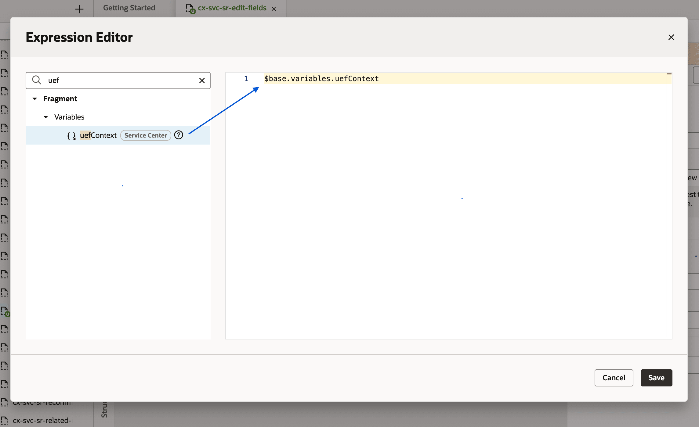

- uefContext which is a mandatory one for any UEF global function and is readily available in all UEF supported pages and fragments
- fieldName which is an optional parameter of type string which accepts fieldName, if user wants to update a field also based on the response from GenAI API.
Note: Users can pass both out-of-the-box fields or custom field's name here.
The response of the global function will have response and status attributes, and if the action fails the status attribute in response will be 'Failed', else it will be 'Success'.
