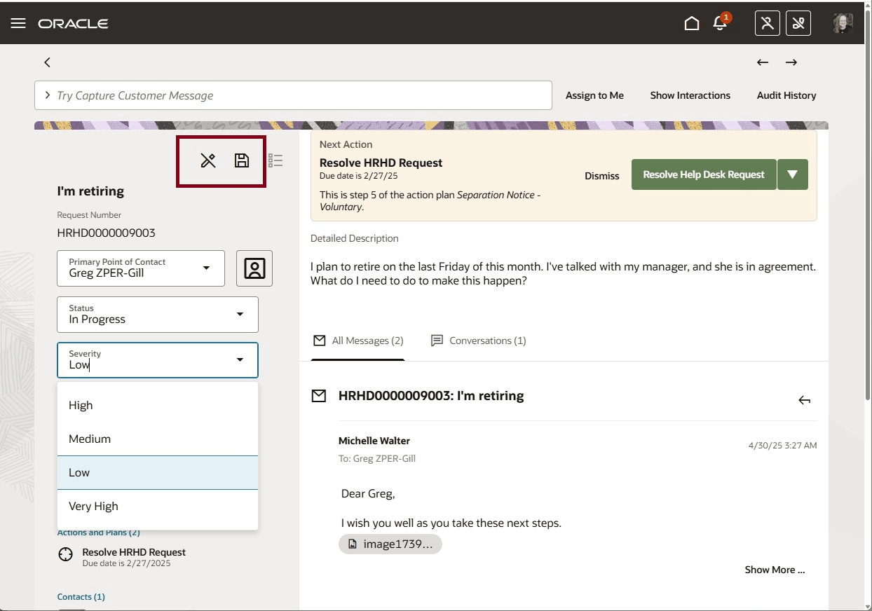

Help Desk Agents now have the ability to Quick Edit those attributes that appear in the Help Desk spotlight area. In the past, these were only available to change through the details page.
Quick Edit
With a click of the Quick Edit pencil icon, these fields become editable, making a quicker and easier way to change attributes like the Status or Severity.
