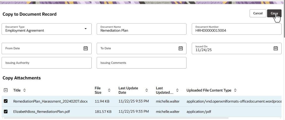

HR Help Desk Agents can directly transfer selected documents to the HCM Document Record for the Primary Contact of the Request. This is done by using the smart action Copy to Document Record.
Copy to Document Record Smart Action
After copying the chosen attachments to the document record, an internal note is created.
Direct transfer of HR documents saves time and ensures security compliance.

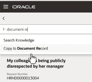

  9. Navigate to Help Desk -> Help Desk Requests.
  10. Navigate to Help Desk Request that has attachments. (Feel free to create a test request if needed.)
  11. In the Action Bar, type Copy to Document Record to make certain the option is shown in the list.

The agent can copy a maximum of 500 attachment to the document record of the primary contact.
If the new smart action does not appear during testing, you may need to sign out and sign in using a new browser window.
