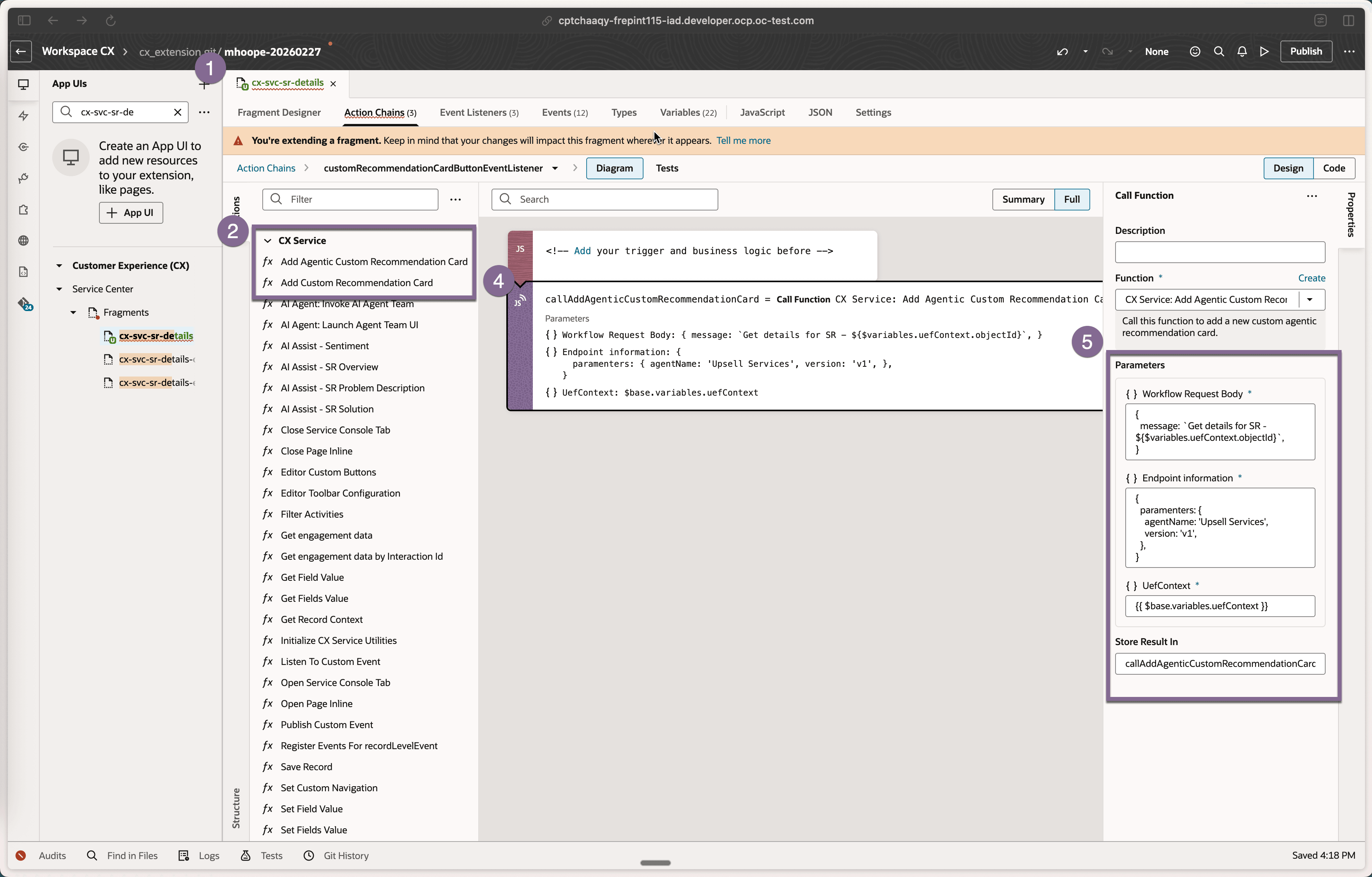

  2. Add Event Hook in Page (VB Studio)
    • Open the target cx-svc-sr-details fragment in Visual Builder Studio
    • Add a record-level event listener
    • Configure a trigger (e.g., field value change such as Severity = High)
  3. Invoke Recommendation Card
    • Use the Add Recommendation Card global action
    • Provide required inputs:
      • Agent name and version
      • Workflow request body (e.g., SR details context)
      • UEF context (available on the page)
