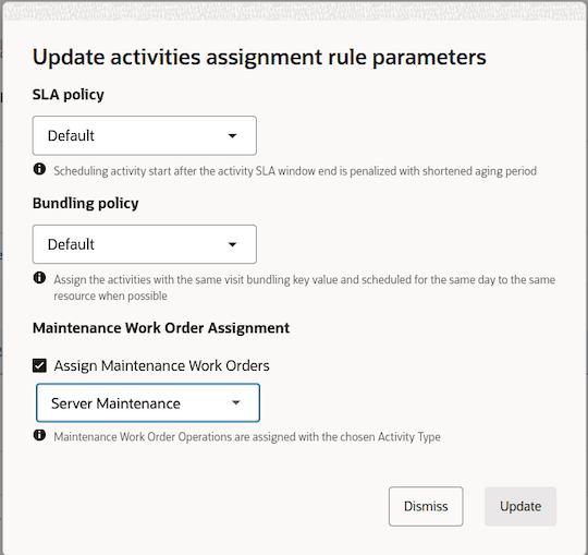

Configure Maintenance Work Order Assignment in Routing
To configure routing for Maintenance Work Order Operations:
  1. Open Oracle Fusion Field Service.
  2. Create or update a filter that identifies the Maintenance Work Order Operations that should be created, scheduled, and assigned by routing.
  3. In the filter, use supported Maintenance Work Order, Maintenance Work Order Operation, and Asset fields to define the type of maintenance work to include.
  4. Go to the routing configuration area.
  5. Open the routing profile and bulk routing plan that should schedule Maintenance Work Order Operations.
  6. Add or select the filter that identifies the Maintenance Work Order Operations to include:
    • If the routing plan uses the simplified filter experience, add or select the filter in the Filters section.
    • If Legacy Assignment Rules is enabled, add or select the filter under Non-scheduled activities in the routing bucket that should be scheduled and assigned.
  7. Open Settings for the selected filter.
  8. In the Maintenance Work Order Assignment setting, select Assign Maintenance Work Orders.
  9. From the dropdown list, select the Field Service Activity Type that should be used when Field Service creates activities from matching Maintenance Work Order Operations. This screenshot shows the Update activities assignment rule parameters section:
This screenshot shows the Update activities assignment rule parameters section on the Routing Plan page.
  1. Save the filter and the routing plan.
  2. Run the bulk routing plan for the applicable bucket.
  3. Confirm that Maintenance Work Order Operations matching the selected filter are evaluated by routing.
  4. Verify that corresponding Field Service activities are created and assigned when routing finds a feasible schedule.
