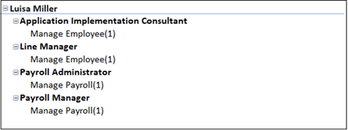

For example, suppose the User Access Risk summary worksheet contains a row stating that a user named Luisa Miller is assigned roles that violate the Manage Employee and Manage Payroll algorithm. (Once again, the algorithm name identifies two entitlements whose access points conflict.)
Open the result worksheet for that algorithm, create the pivot table, and search for the user name. You'll find a set of records that looks like this:
Each role associated with one entitlement conflicts with every role associated with the other entitlement. In this example, there are four conflicts: Application Implementation Consultant with Payroll Administrator, Application Implementation Consultant with Payroll Manager, Line Manager with Payroll Administrator, and Line Manager with Payroll Manager.
Your typical recourse is to rescind the user's access to one of the roles in each conflict. In this example, you would use the Security Console to remove either Application Implementation Consultant and Line Manager, or Payroll Administrator and Payroll Manager. Another option is to create customized versions of the two roles you would otherwise take away. Each custom role would remove a conflicting access point, but retain other access rights.
