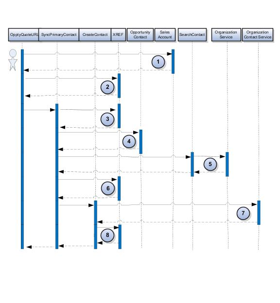

Detailed Contact Data Matching Process
         When a salesperson clicks the Quote tab or the Create Quote button in an opportunity in Oracle CX Sales:
The process returns the Account object from Oracle CX Sales, and determines the synchronization status.
If the customer was synchronized previously, then the process returns the remote customer identification from the XREF custom object. The remote customer identification already exists in Oracle E-Business Suite because of a previous synchronization.
The process reads the remote contact identification from the XREF object.
The process fetches the primary contact from the Opportunity Contact object in Oracle CX Sales.
The process calls the GetOrganization method in the Organization Service web service in Oracle E-Business Suite using the remote customer identification as an input argument.
If the returned organization has a matching contact, then the process creates an XREF object with the local and remote contact identifications.
If there are no matching contacts or more than one matching contact, then the process calls the createOrgContact method in the Organization Contact Service web service in Oracle E-Business Suite. The createOrgContact method returns the remote contact identification from Oracle E-Business Suite.
The process creates an XREF object using the local and remote contact identifications.
