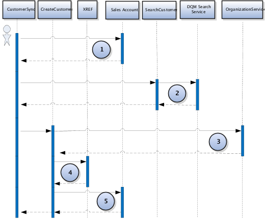

Detailed Customer Data Matching Process
When a salesperson performs a customer matching operation in Oracle CX Sales the following sequence takes place:
The process returns the Account object from Oracle CX Sales, and determines the customer synchronization status.
If the customer is not synchronized, or if the status is null, then the process calls the FindParties method in the DQM Search Service web service to perform a customer search in Oracle E-Business Suite. The customer search returns a list of matching candidates.
If there is no matching record, then the process calls the CreateOrganization method in the Organization Service web service in Oracle E-Business Suite. Organization Service returns the remote customer identification.
The process creates an XREF custom object in Oracle CX Sales using the local identification in Oracle CX Sales and the remote identification from Oracle E-Business Suite.
The process sets the synchronization status to Synchronized.
