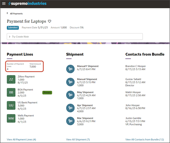

Here's a screenshot of a rollup that displays in a panel for a payment.

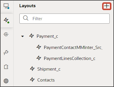

First, create the rollup layout:

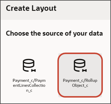

In Visual Builder Studio, click the Layouts tab, then click the Create Layout icon.
In the Create Layout dialog, click the REST resource for your child object.
In our example, the rollup object is called RollupObject. So, expand cx-custom and click Payment_c/RollupObject_c.
Click Create.

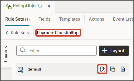

Next, create the associated rule set.
On the RollupObject_c layout tab, click + Rule Set to create a new rule set for the layout.
In the Create Rule Set dialog, in the Component field, select Dynamic Form.
In the Label field, enter PaymentLinesRollup.
In the ID field, change the value to PaymentLinesRollup.
Click Create.

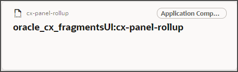

Click the cx-panel-rollup fragment.
This fragment provides the format for the rollup region.

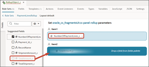

The rollup layout includes two slots. From the list of fields, drag a rollup field to the desired slot.
For example, drag the TotalAmount_c field to the item2 slot.

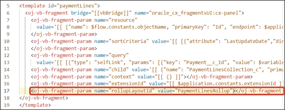

Next, add the rollups region to a panel by adding a parameter to the panel's page and template. Here's how:
In Visual Builder Studio, click the App UIs tab.
Expand cx-custom > payment_c, then click the payment_c-detail node.
Click the payment_c-detail tab, then click the Page Designer subtab.

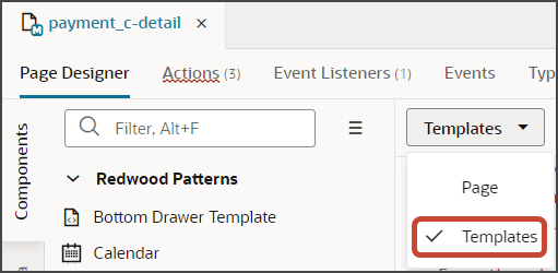

Click the Code button.
Select Templates from the drop-down list.
Add the following parameter to the fragment code.
<oj-vb-fragment-param name="rollupLayoutId" value="PaymentLinesRollup"></oj-vb-fragment-param>Be sure to replace the
rollupLayoutIdparameter's value with the appropriate value.The resulting template code should look something like this:
<template id="paymentLines"> <oj-vb-fragment bridge="[[vbBridge]]" name="oracle_cx_fragmentsUI:cx-panel"> <oj-vb-fragment-param name="resource" value='[[ {"name": $flow.constants.objectName, "primaryKey": "Id", "endpoint": $application.constants.serviceConnection } ]]'> </oj-vb-fragment-param> <oj-vb-fragment-param name="sortCriteria" value='[[ [{"attribute": "LastUpdateDate","direction": "desc" }] ]]'> </oj-vb-fragment-param> <oj-vb-fragment-param name="query" value='[[ [{"type": "selfLink", "params": [{"key": "Payment__c_Id", "value": $variables.id }]}] ]]'></oj-vb-fragment-param> <oj-vb-fragment-param name="child" value='[[ {"name": "PaymentLinesCollection_c", "primaryKey": "Id", "relationship": "Child"} ]]'></oj-vb-fragment-param> <oj-vb-fragment-param name="context" value="[[ {} ]]"></oj-vb-fragment-param> <oj-vb-fragment-param name="extensionId" value="{{ $application.constants.extensionId }}"></oj-vb-fragment-param> <oj-vb-fragment-param name="rollupLayoutId" value="PaymentLinesRollup"></oj-vb-fragment-param> </oj-vb-fragment> </template>

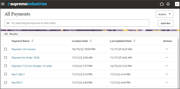

Test the rollups by previewing your application extension from the payment_c-list page.
From the payment_c-list page, click the Preview button to see your changes in your runtime test environment.
The resulting preview link will be:
https://<servername>/fscmUI/redwood/cx-custom/payment_c/payment_c-list -
Change the preview link as follows:
https://<servername>/fscmUI/redwood/cx-custom/application/container/payment_c/payment_c-listNote:You must add
/application/containerto the preview link.The screenshot below illustrates what the list page looks like with data.

You should now see the Payment Lines panel on the detail page, with a region for rollups.
