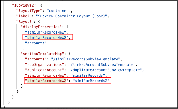

- Add the following entry to the  JSON file.  You must also add the alias
                        mentioned in the subview template as the key for exposing your subview
                                template.

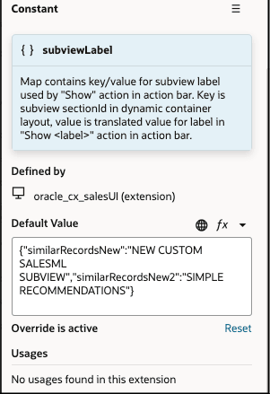

- Add an entry as follows for the subview label variable. Note: An existing variable calledsubviewLabelalready exists for standard objects.The entry in the subview label will need your key and value. Key would be the key used to expose your subview template. Value would decide the action name ( prefixing with 'Show' ) that shows up in action bar.
