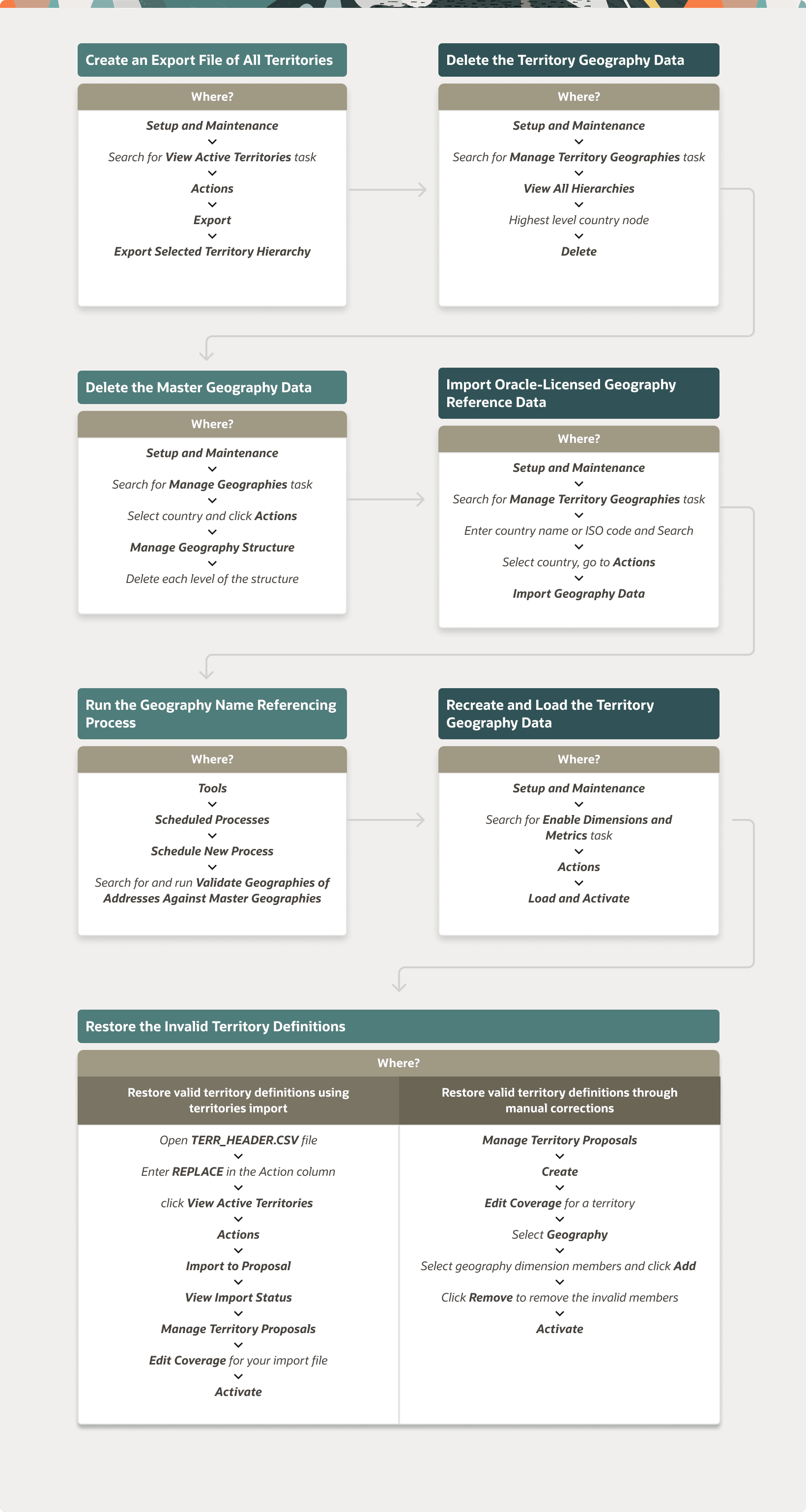

The process of replacing the existing master geography data with revised Oracle-Licensed geography data is depicted in this diagram:
This image depicts the process of replace geography data.

  9. Click Close.
  10. In the Schedule Processes page, click the Refresh icon.
  11. Review the status of the process job and verify if it has completed successfully.
    Review a small subset of the open opportunities to confirm that the territory assignment is as expected.
To run the batch assignment process for sales accounts:
  1. Ensure that the ZCA_SA_AUTO_ASSIGN_ON_CREATE and ZCA_SA_AUTO_ASSIGN_ON_UPDATE profile options are set to Yes in the Manage Customer Center Profile Options task.
  2. From Navigator, click Customers.
  3. In the Customers page, click Create Account.
  4. In the Create Account page, enter a name and address of the sales account, and select the Address is sell to check box.
  5. Click Save and Close.
  6. From Navigator, click Customers.
  7. In the Search pane, search for the name of the sales account you created and select it.
  8. In the section Customer Information, select Sales Account Team. The details of the sales account and territories associated with the sales account are displayed.
    This indicates that the sales account was created successfully and the batch assignment was run automatically to assign the matching territories to the sales account.
To run the batch assignment process manually from the Scheduled Processes page, perform the following steps.
  1. From Navigator, click Scheduled Processes.
  2. In the Schedule Processes page, click Schedule New Process.
  3. In the Schedule New Process dialog box, search for the Request Account Assignment process and select it.
  4. Click OK.
  5. Enter SalesAccount_Work_Object in the Work Object Code field and SalesAccountTerritory_Candidate_Object in the Candidate Object Code field.
  6. Select Territory in the Assignment Mode list.
  7. Enter AllSalesAccountsVC in the View Criteria Name field. This selects all sales accounts.
  8. Click Submit to schedule the process.
  9. In the Confirmation dialog box, make a note of the process identifier for monitoring the process, and click OK.
  10. Click Close.
  11. In the Schedule Processes page, click the Refresh icon.
  12. Review the status of the process job and verify if it has completed successfully.
    Review a small subset of the accounts to confirm that the territory assignment is as expected.
Verify that the downstream applications using geography data is working fine.
