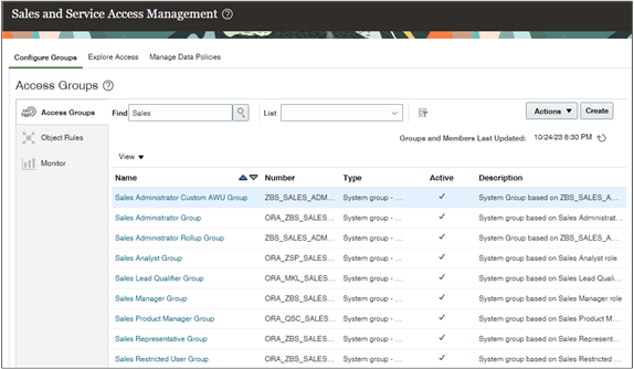

For each of the custom job roles, search for the corresponding access group and check that the access group lists the users that require access.
Each time you create a custom job role, the application automatically creates an access group with the same name, appending the term Group. In this procedure, you're assigning these custom access groups (not the custom job roles themselves) to the data security rules.
Using the Find field, search for an access group that corresponds to the custom job role.

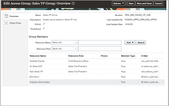

Drill down in to the access group to make sure the users that need access are members of the group.

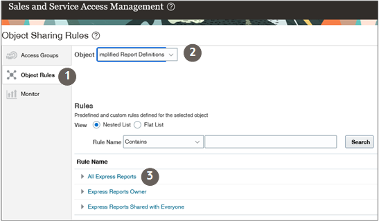

Rule Description Recommendation All Express Reports Provides access to all express reports. Add only administrator job roles to this rule. Oracle recommends you provide these roles with the Full access level. This level lets administrators create, update, delete, and share reports. Express Reports Owner Gives owners of a report access to the reports they own. Add all job roles for users who create reports to this rule. Provide them with the Full access level. Express Reports Shared with Everyone Provides access to reports shared by administrators. Add job roles you want to grant access to shared reports. Set the access level to Read as you don't want users deleting or editing reports shared by administrators. - On the Access Groups page, click the Object Rules tab in the left pane (callout 1 in the screenshot).
- From the Object Sharing Rules page, Object field (callout 2), select Simplified Report Definitions.
Drill down on each rule (callout 3).

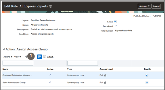

In the Edit Rule page, Action: Assign Access Group section, click Select and Add (the plus icon highlighted by callout 1 in the following screenshot.)
- In the Select and Add: Access Group window, search for the access group corresponding to the custom job role and click OK.
- Select an Access Level. The recommended settings are:
- Full for the All Express Reports and Express Reports Owner rules.
- Read for the Express Reports Shared with Everyone rule.
- Make sure the Enable option is selected.
- Save using the Actions button.

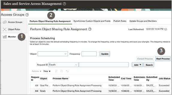

- When the process completes, click the Perform Object Sharing Rule Assignment subtab (callout 2 on the following screenshot) on the Monitor tab (callout 1).
Click Start Process (callout 3).
