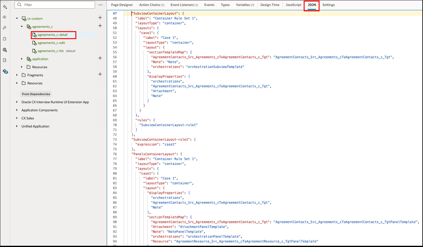

  14. Next, click the JSON tab and search for PanelsContainerLayout.
    Sample screenshot of the JSON code used in the Agreements custom object in Visual Builder Studio
  15. After displayProperties, add the entry for the guidance panel to make it available in the foldout page. Also after the sectionTemplateMap, provide the orchestrationPanel template ID.
    PanelsContainerLayout Example

  16. Similar to the PanelsContainerLayout example, search for SubviewContainerLayout.
  17. After displayProperties, add the entry for the guidance subview. Also, after the sectionTemplateMap, provide the guidance subview template ID.
    SubviewContainerLayout Example
