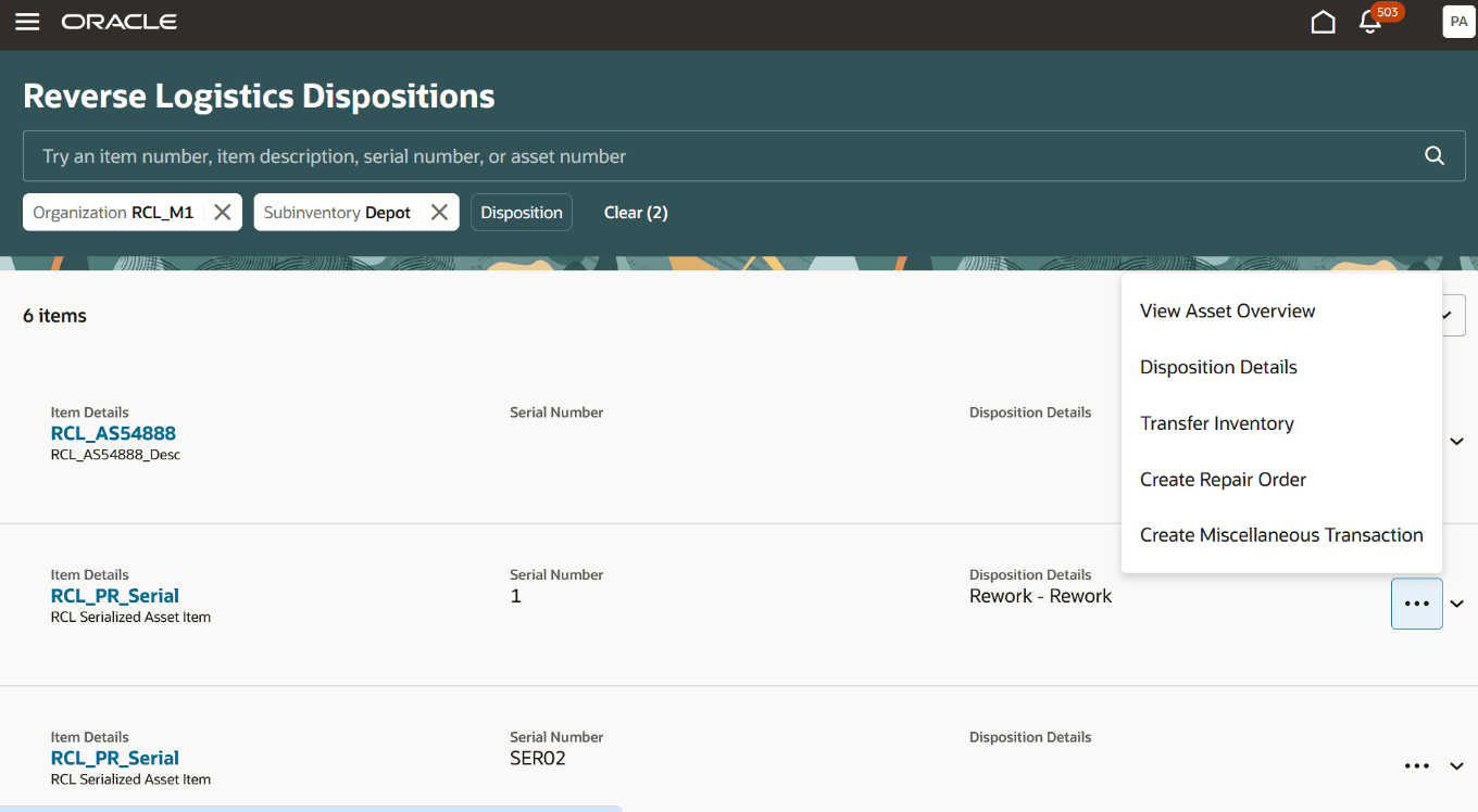

Reverse Logistics Dispositions page
The Reverse Logistics Dispositions page lists inventory items from all stocking locations for the selected organization and subinventory.
The Reverse Logistics Disposition page includes the:
  • Search bar
  • Filter Chips suggestion bar
  • Magnifying Glass icon
  • Reverse Logistics Disposition results table
These are described in the following table:

Search bar
The search bar opens with filter chips, which you can add or delete depending on your search needs. The selectable filter chips include:
  • Organization (LOV)
  • Subinventory (LOV)
  • Disposition Code (LOV)
You can also enter free text, which will search the following estimates attributes:
  • Item Number
  • Item Description
  • Serial Number
  • Asset Number
Because the application supports autocomplete and fuzzy logic, you can partially type your search terms.
You can use the Magnifying Glass icon to search for the attributes selected in the search bar.
The Reverse Logistics Disposition results table lists the items based on your search criteria and filters.
From the search results, you can take the following actions for each item:
  • View Asset Overview: Opens the Asset Overview page.
  • Disposition Details: Opens the New Disposition Details page.
  • Transfer Inventory: Opens a side drawer to perform inventory transactions.
  • Create Transfer Order: Opens a side drawer to create transfer orders.
  • Create Repair Order: Opens a side drawer to create a repair order and allows you to capture a work order description.
  • Create Miscellaneous Transaction: Opens a side drawer to create transactions.
  • Delete Disposition: Deletes a disposition record for a returned item before any inventory or repair order transactions are performed.
