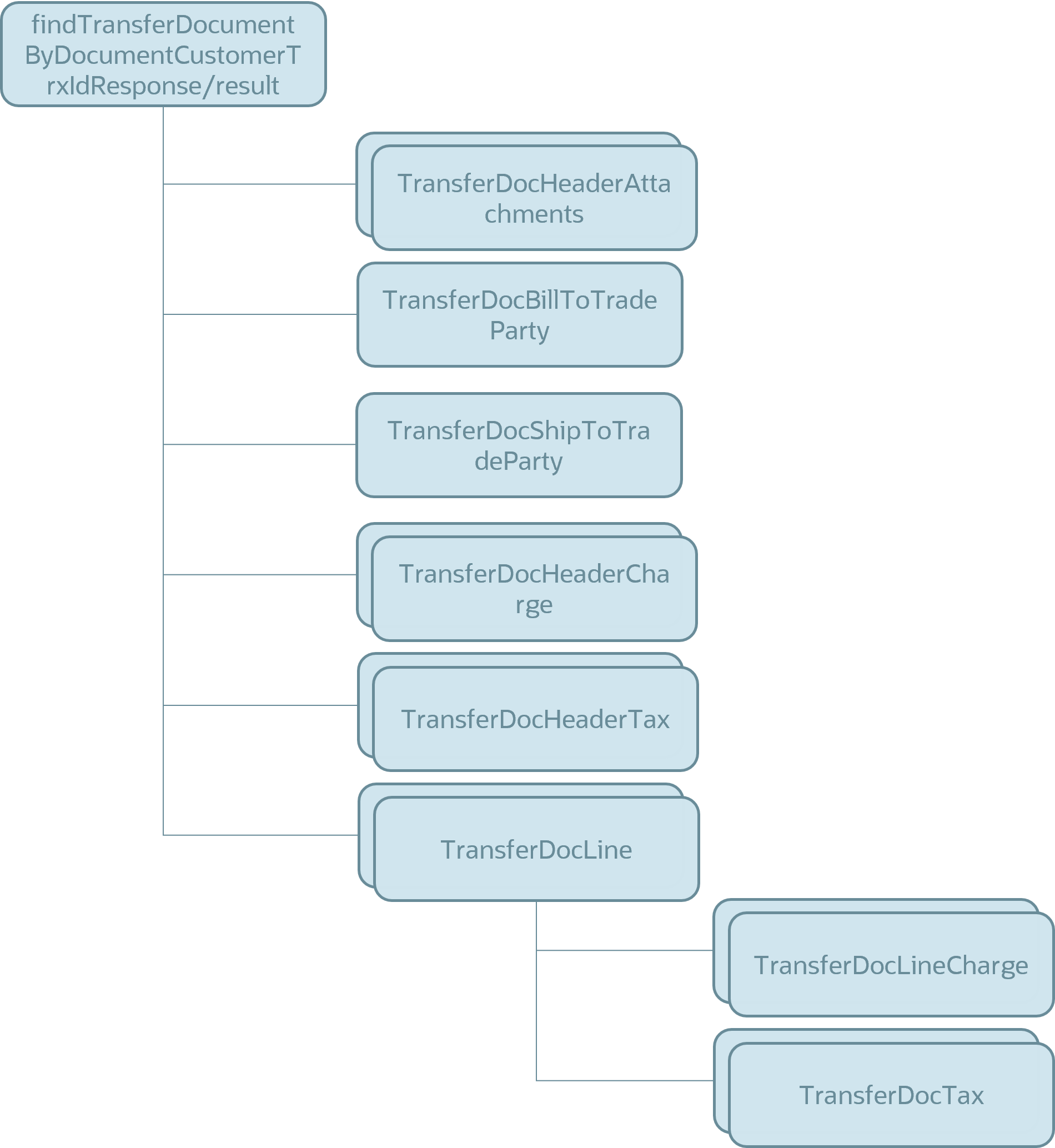

Figure 1
Figure 1 shows the structure of the inbound payload that’s received from the application.

Sample Payload
Here is a sample of the payload that’s sent for the UBL-2.1-PEPPOL-Invoice-Out message.
<sendCollaborationDocument xmlns="http://xmlns.oracle.com/apps/scm/cmk">
<CollaborationEvent testFlag="true" testResult="Success">
<CollaborationEventName>ProcessInvoiceInitiated</CollaborationEventName>
<RecipientKey1>1245</RecipientKey1>
<RecipientKey2>2959</RecipientKey2>
<RecipientKeyType>CustomerAccount</RecipientKeyType>
<ObjectKey1>1003</ObjectKey1>
<ObjectKey2>300001306852235</ObjectKey2>
<ObjectKey3>5058</ObjectKey3>
</CollaborationEvent>
<Document>
<ns3:findTransferDocumentByDocumentCustomerTrxIdResponse xmlns:ns0="http://xmlns.oracle.com/apps/financials/receivables/transactions/shared/documentTransferService/types/" xmlns:wsa="http://www.w3.org/2005/08/addressing" xmlns:ns3="http://xmlns.oracle.com/apps/financials/receivables/transactions/shared/documentTransferService/types/">
