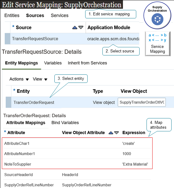

For example, create a service mapping that uses the TransferOrderRequest entity in the TransferRequestSource service.
The service sends a request to create a transfer order from Supply Chain Orchestration to Inventory Management.
- Edit the SupplyOrchestration service mapping.
- Select the TransferRequestSource source.
- Select the TransferOrderRequest entity.
- Map your attributes. For example:
Attribute Expression AttributeChar1 'create' AttributeNumber1 1000 NotetoSupplier 'Extra Material'
