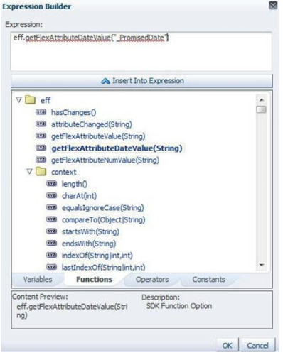

Example of Choosing a Function
Use the Functions tab in the Expression Builder dialog to get a list of arguments you can use. For example, with method getFlexAttributeDateValue.
tab Functions in dialog Expression Builder
