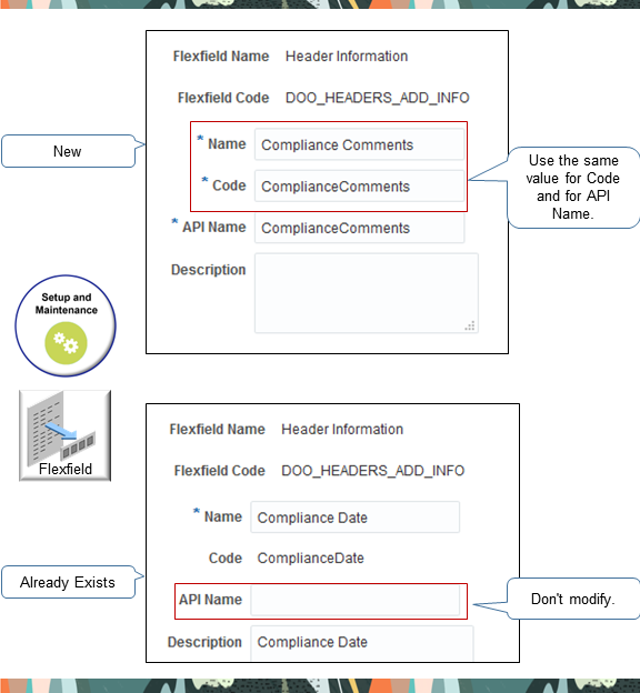

Create Segments and Contexts
If you:
| Create or Modify | Then |
| Create a new segment. |
Use the same value for the Code attribute and the API Name attribute. This will simplify setup and maintenance. You use API Name throughout the setup, such as when you integrate with web services, business rules, business intelligence, and so on. You can't modify Code or API Name after you create the segment. |
| Modify a segment that already exists. | Don't modify API Name. Extensible flexfield logic examines API Name. If it's empty, then the logic uses the value in Code, so it isn't necessary to specify a value in API Name. If you do modify API Name, then your flexfield might fail with unexpected results at run time. |
Note
Enter a unique code, name, and description for each segment. The Order Management work area doesn't display these values, so use whatever nomenclature is most helpful to you during setup and maintenance.
- You must not enable the Translatable option on the context. For details, see Set Up Extensible Flexfields in Order Management.

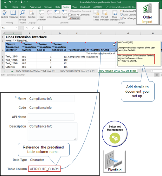

Use File Based Data Import
Use these guidelines when you use the order import template to import data for an extensible flexfield:
Assign each segment's Table Column attribute so it references the correct column in the order import template.
Use the DOO_ORDER_HDRS_ALL_EFF_B_INT worksheet to capture details for order headers.
Use the DOO_ORDER_LINES_ALL_EFF_B_INT worksheet to capture details for fulfillment lines.
Use columns, such as ATTRIBUTE_CHAR1, to capture details for each attribute.
Don't modify worksheet names or column names. Instead, add a comment.
Add a comment in Excel to document your set up.
You can use with an extensible flexfield only with these entities:
Header
Fulfillment line
Fulfillment line detail
You can't add an extensible flexfield on the order line entity. You can add one only on the order header entity or the fulfillment line entity. The template uses the phrase DOO_ORDER_LINES, but it uses details that you add on the DOO_ORDER_LINES_ALL_EFF_B_INT worksheet to interact with extensible flexfields on the fulfillment line, not on the order line. See Import Orders Into Order Management.
This example illustrates how to set up the Compliance Info segment that references the ATTRIBUTE_CHAR1 column:

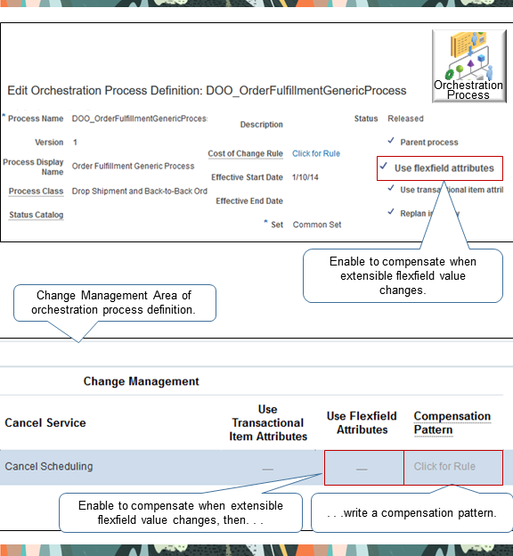

Manage Change
Identify your requirements for change management. For example, figure out whether the orchestration process must compensate when you change the value in an extensible flexfield and the action to take when you compensate, such as schedule, call Oracle Receivables, and so on.
Set up the orchestration process differently depending on whether the value that it references changes any flexfield or a specific one:
| Compensate Value For | Enable the Use Flexfield Attributes option |
| Any extensible flexfield | On the header of the orchestration process definition. |
| A specific extensible flexfield |
In the Change Management section of the orchestration process definition. Add it to the orchestration process step that references the extensible flexfield. Also set up a compensation pattern on this step. Use the compensation pattern to specify the action to do, such as Cancel, Create, Update, and so on, depending on the value that changes. Your set up can send an update when a single value changes and skip sending an update when other values change. This approach provides more detailed control regarding the compensation that you do. |
Here's an example compensation pattern:
pseudocode:
If segment3 changes, then cancel task x, and then recreate task x.
If segment4 changes, then do nothing.
If segment5 changes, then call an update service.
For a detailed example, see Compensate Sales Orders That Change.
To ignore changes to all extensible flexfield values, make sure Use Flexfield Attributes for each step in the Change Management section isn't enabled.
Change management ignores each change that you make to an extensible flexfield's value at run time when it's on order header.

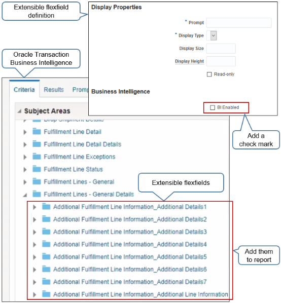

Modify Analytics
Oracle Transaction Business Intelligence (OTBI) provides analytic reporting. You can display extensible flexfield data in OTBI.
Note
Enable the BI Enabled option when you set up your extensible flexfield.
Run the Import Oracle Fusion Data Extensions for Transactional Business Intelligence scheduled process. This process updates OTBI so it displays your extensible flexfields in area Subject Areas in OTBI. For details, see Overview of Flexfield Change Import.
Add your extensible flexfields from Subject Areas into a report in OTBI.
Here's the format that OTBI uses.
Category_ContextFor example:
Additional Fulfillment Line Information_Additional Details1where
Additional Fulfillment Line Informationis the category. -
Additional Details1is the context.
