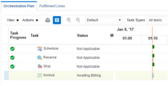

In the fulfillment line for the coverage item, in the Orchestration Process Number column, click the link.
On the Orchestration Process page, on the Orchestration Plan tab, notice that the Status for each shipping task, such as Schedule, Reserve, or Ship, is Not Applicable.
A warranty isn't a shippable item, so the orchestration process doesn't attempt to ship it.
