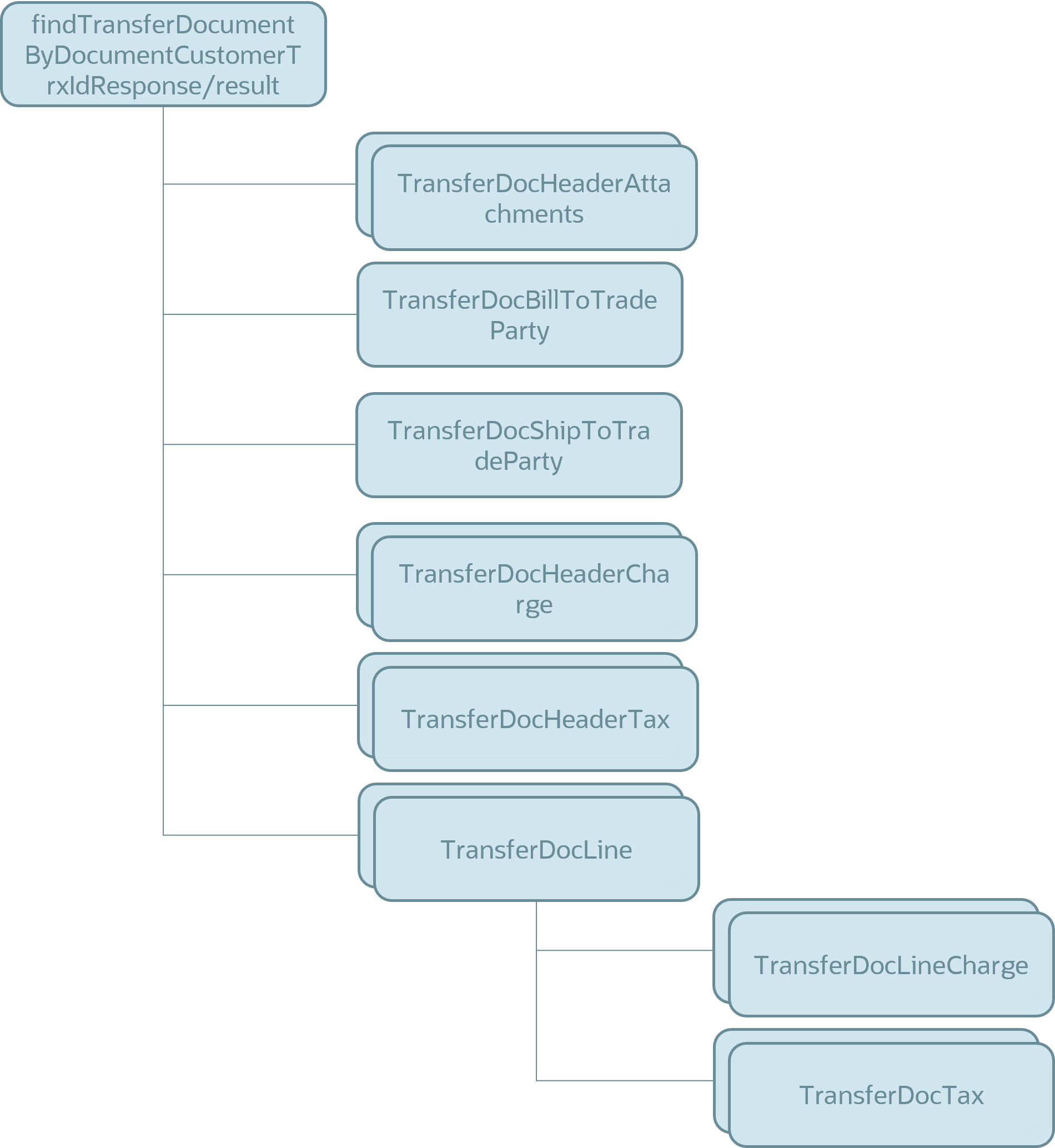

Figure 1
Figure 1 shows the structure of the inbound payload that’s received from the application.
Structure of inbound payload

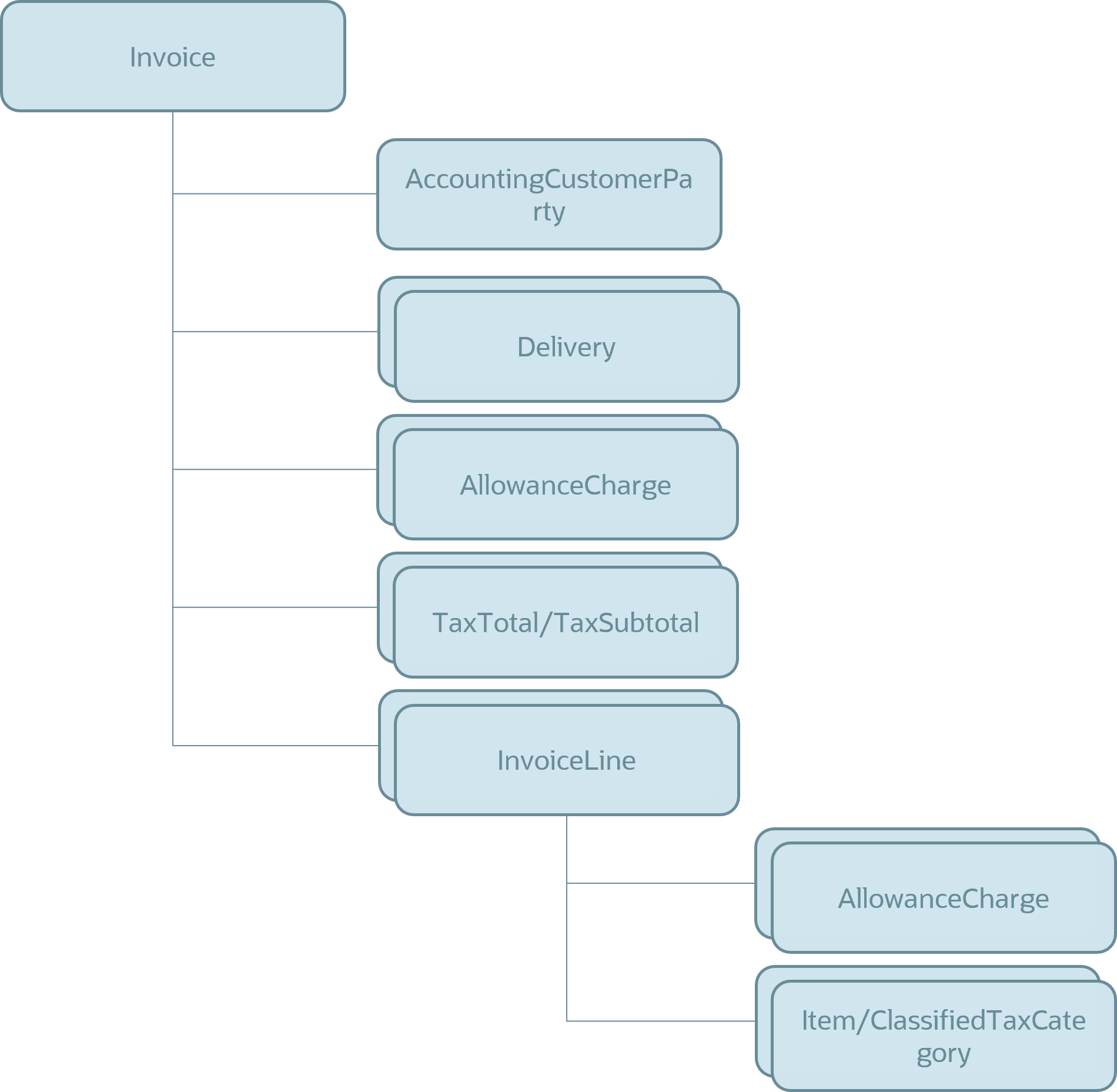

Figure 2
Figure 2 shows the structure of the UBL-2.1-PEPPOL-Invoice-Out payload that’s sent to the customer. Structure of payload sent to the customer
This table shows where the data that’s received from the application is mapped to in the UBL-2.1-PEPPOL-Invoice-Out message that’s sent to the customer.
