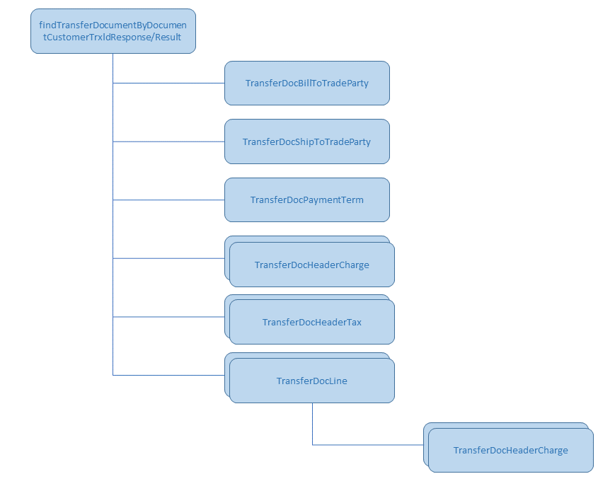

Data Mapping
The below figure shows the structure of the payload that's received from the application for the UBL-2.1-PEPPOL-Invoice-Out-V2 message.
Refer to Figure 2 in UBL-2.1-PEPPOL-Invoice-Out for the structure of the payload that's sent to the customer.

| PostalCode | DeliveryLocation/Address/PostalZone |
| AddressLineOne | DeliveryLocation/Address/AddressLine/Line |
| CountryCode | DeliveryLocation/Address/Country/IdentificationCode There is a predefined DVM, COUNTRY_CODE in use for this field. |
| PartyName | DeliveryParty/PartyName/Name |
| TransferDocHeaderCharge | AllowanceCharge |
| ChargeIndicator This is set to true. |
| LineType | AllowanceChargeReasonCode There is a predefined DVM, CHANGE_REASON_CODE in use for this field. |
| LineType | AllowanceChargeReason |
| result/CurrencyCode | Amount/@currencyID There is a predefined DVM, CURRENCY_CODE in use for this field. |
| ChargeAmount | Amount |
| TaxCategory/ID This is set to E. |
| TaxCategory/Percent This is set to 0. |
| TaxCategory/TaxScheme/ID This is set to VAT. |
| TransferDocLine |
InvoiceLine If DocumentType is 'CM' and $passCreditNote "true()", then the element is CreditNoteLine. Otherwise, the element is InvoiceLine. |
| TransferDocLine/TransferDocLineCharge | AllowanceCharge TransferDocLine/TransferDocLineCharge is mapped if result/TransferDocHeaderCharge does not exist. There is one AllowanceCharge per LineType. |
| LineType | AllowanceChargeReasonCode There is a predefined DVM, CHARGE_REASON_CODE in use for this field. |
| sum(TransferDocLineCharge[LineType = $current]/ChargeAmount) | Amount |
| result/CurrencyCode | TaxTotal/TaxAmount/@currencyID There is a predefined DVM, CURRENCY_CODE in use for this field. |
| TotalTaxAmount | TaxTotal/TaxAmount |
| TaxTotal/TaxSubtotal/ Set to totalChargeAmount if it exists. |
| result/CurrencyCode | TaxableAmount/@currencyID There is a predefined DVM, CURRENCY_CODE in use for this field. |
| totalChargeAmount + totalTaxExemptTaxableAmount | TaxableAmount totalChargeAmount sums up the ChargeAmount at header if TransferDocHeaderCharge exists on header. Otherwise, it sums up the ChargeAmount at the line. totalTaxExemptTaxableAmount sums up the TaxableAmount at the header where the TaxRateCode is equal to the taxExemptCode. |
| result/CurrencyCode | TaxAmount/@currencyID There is a predefined DVM, CURRENCY_CODE in use for this field. |
| TaxAmount This is set to 0. |
| TaxCategory/TaxExemptionReason This is set to Exempt. |
| TransferDocHeaderTax | TaxTotal/TaxSubtotal TransferDocHeaderTax is mapped if TaxRateCode it is not exempt. |
| TaxableAmount | TaxableAmount |
| TaxAmount | TaxAmount |
| TaxRateCode | TaxCategory/ID There is a predefined DVM, TAX_CATEGORY_CODE in use for this field. |
| TaxRate | TaxCategory/Percent If no value is provided, this is set to 0. |
| ExemptReasonCode | TaxCategory/TaxExemptionReasonCode |
| ExemptReason | TaxCategory/TaxExemptionReason If no value is provided, this is set to Exempt. |
| result/CurrencyCode | LegalMonetaryTotal/LineExtensionAmount/@currencyID There is a predefined DVM, CURRENCY_CODE in use for this field. |
| LineExtensionAmount | LegalMonetaryTotal/LineExtensionAmount |
| CurrencyCode | LegalMonetaryTotal/TaxExclusiveAmount/@currencyID There is a predefined DVM, CURRENCY_CODE in use for this field. |
| TaxExclusiveAmount | LegalMonetaryTotal/TaxExclusiveAmount |
| CurrencyCode | LegalMonetaryTotal/TaxInclusiveAmount/@currencyID There is a predefined DVM, CURRENCY_CODE in use for this field. |
| InvoiceAmount | LegalMonetaryTotal/TaxInclusiveAmount |
| CurrencyCode | LegalMonetaryTotal/AllowanceTotalAmount/@currencyID There is a predefined DVM, CURRENCY_CODE in use for this field. |
| sum(tns:TransferDocPaymentTerm[tns:DiscountAmount != '']/tns:DiscountAmount) | LegalMonetaryTotal/AllowanceTotalAmount The sum of TransferDocPaymentTerm/DiscountAmount is mapped if it exists. |
| CurrencyCode | LegalMonetaryTotal/ChargeTotalAmount/@currencyID There is a predefined DVM, CURRENCY_CODE in use for this field. |
| sum(TransferDocHeaderCharge[ChargeAmount != '']/ChargeAmount) or sum(TransferDocLine[TransferDocLineCharge]/TransferDocLineCharge[LineType != '']/ChargeAmount) | LegalMonetaryTotal/ChargeTotalAmount The sum of TransferDocHeaderCharge/ChargeAmount is mapped if it exists or else the sum of the TransferDocLine/TransferDocLineCharge/ChargeAmount is mapped. |
| CurrencyCode | LegalMonetaryTotal/PrepaidAmount/@currencyID If the LegalEntityCountryCode is France (FR), then map CurrencyCode. There is a predefined DVM, CURRENCY_CODE in use for this field. |
| PrepaymentAmount | LegalMonetaryTotal/PrepaidAmount If the LegalEntityCountryCode is France (FR), then map PrepaymentAmount. |
| CurrencyCode | LegalMonetaryTotal/PayableRoundingAmount/@currencyID If the LegalEntityCountryCode is France (FR), then map CurrencyCode. There is a predefined DVM, CURRENCY_CODE in use for this field. |
| OrderRoundingAmount InvoiceAmount | LegalMonetaryTotal/PayableRoundingAmount If the LegalEntityCountryCode is France (FR), then map OrderRoundingAmount otherwise map InvoiceAmount. |
| CurrencyCode | LegalMonetaryTotal/PayableAmount/@currencyID |
| InvoiceAmount | LegalMonetaryTotal/PayableAmount |
| TransferDocLine |
InvoiceLine if DocumentType is 'CM' and $passCreditNote "true()" then the element is CreditNoteLine. Otherwise, the element is InvoiceLine. |
| LineNumber | ID |
| Description | Note |
| UnitOfMeasure |
InvoicedQuantity/@unitCode If DocumentType is 'CM' and $passCreditNote "true()" then the element is CreditedQuantity. Otherwise, the element is InvoicedQuantity. There is a predefined DVM, UOM_CODE in use for this field. |
| Quantity |
InvoicedQuantity If DocumentType is 'CM' and $passCreditNote "true()" then the element is CreditedQuantity. Otherwise, the element is InvoicedQuantity. |
| LineAmount | LineExtensionAmount |
| TransferDocSalesOrder[1]/SalesOrderLine | OrderLineReference/LineID If the LegalEntityCountryCode is not France (FR), then map TransferDocSalesOrder[1]/SalesOrderLine. Otherwise, if the LegalEntityCountryCode is France (FR) then map TransferDocSalesOrder/SalesOrderLine. |
| TransferDocSalesOrder/SalesOrderLine | OrderLineReference/SalesOrderLineID If the LegalEntityCountryCode is France (FR), then TransferDocSalesOrder/SalesOrderLine is mapped. |
| TransferDocSalesOrder/SalesOrder | OrderLineReference/OrderReference/ID If the LegalEntityCountryCode is France (FR), then TransferDocSalesOrder/SalesOrder is mapped. |
| ShipToLocAddress1 | Delivery/DeliveryLocation/Address/StreetName If the LegalEntityCountryCode is France (FR), then ShipToLocAddress1 is mapped. |
| ShipToLocAddress2 | Delivery/DeliveryLocation/Address/AdditionalStreetName If the LegalEntityCountryCode is France (FR), then ShipToLocAddress2 is mapped. |
| ShipToLocAddress3 | Delivery/DeliveryLocation/Address/AddressLine/Line If the LegalEntityCountryCode is France (FR), then ShipToLocAddress3 is mapped. |
| ShipToLocCity | Delivery/DeliveryLocation/Address/CityName If the LegalEntityCountryCode is France (FR), then ShipToLocCity is mapped. |
| ShipToLocPostalCode | Delivery/DeliveryLocation/Address/PostalZone If the LegalEntityCountryCode is France (FR), then ShipToLocPostalCode is mapped. |
| ShipToLocCounty | Delivery/DeliveryLocation/Address/CountrySubentity If the LegalEntityCountryCode is France (FR), then ShipToLocCounty is mapped. |
| ShipToLocCountry | Delivery/DeliveryLocation/Address/Country/IdentificationCode
If the LegalEntityCountryCode is France (FR), then ShipToLocCountry is mapped. |
InvoiceLine/AllowanceCharge If DocumentType is 'CM' and $passCreditNote "true()" then the element is CreditNoteLine. Otherwise, the element is InvoiceLine. |
| LineType |
| ItemDescription | Item/Description |
| TranslatedDescription | Item/Name Set to Item Name. |
| TpItemDesc | Item/BuyersItemIdentification/ID |
| ItemNumber | Item/SellersItemIdentification/ID |
| ItemCategoryName | CommodityClassification/ItemClassificationCode |
| TransferDocLine/TransferDocTax |
InvoiceLine/Item/ClassifiedTaxCategory If DocumentType is 'CM' and $passCreditNote "true()" then the element is CreditNoteLine. Otherwise, the element is InvoiceLine. |
| TaxRateCode | ID There is a predefined DVM, TAX_CATEGORY_CODE in use for this field. |
| TaxRate | Percent |
| result/CurrencyCode | Price/PriceAmount/currencyID There is a predefined DVM, CURRENCY_CODE in use for this field. |
| UnitSellingPrice | Price/PriceAmount |

<ns1:DocFiscClassifName xsi:nil="true"/>
<ns1:DocFiscClassifCode xsi:nil="true"/>
<ns1:CmIssueDate xsi:nil="true"/>
<ns1:PaymentStatus>NOT PAID</ns1:PaymentStatus>
<ns1:ProductType>GOODS</ns1:ProductType>
<ns1:FinalInvoice>N</ns1:FinalInvoice>
<ns1:MaskedCcNumber>xxxx1234</ns1:MaskedCcNumber>
<ns1:CcHolderName>JOHN</ns1:CcHolderName>
<ns1:PrepaymentAmount>0</ns1:PrepaymentAmount>
<ns1:OrderRoundingAmount>-4000</ns1:OrderRoundingAmount>
<ns1:TransferDocHeaderCharge>
<ns1:ChargeAmount currencyCode="USD">10000</ns1:ChargeAmount>
<ns1:LineType>FREIGHT</ns1:LineType>
<!-- CHARGE_REASON_CODE -->
</ns1:TransferDocHeaderCharge>
<ns1:TransferDocLineCharge>
<ns1:ChargeAmount>5.00</ns1:ChargeAmount>
<ns1:LineType>MISC</ns1:LineType>
</ns1:TransferDocLineCharge>
<ns1:TransferDocLine>
<ns1:LineType>LINE</ns1:LineType>
<ns1:LineNumber>1</ns1:LineNumber>
<ns1:LineAmount currencyCode="USD">100000</ns1:LineAmount>
<ns1:CurrencyCode>EUR</ns1:CurrencyCode>
<ns1:UnitSellingPrice currencyCode="USD">500</ns1:UnitSellingPrice>
<ns1:Quantity unitCode="Ea">200</ns1:Quantity>
<ns1:Description>Sentinel Personal</ns1:Description>
<ns1:UnitOfMeasure>Ea</ns1:UnitOfMeasure>
<!-- UOM_CODE -->
<ns1:Item>PTO54222</ns1:Item>
<ns1:ItemDescription>Sentinel Personal</ns1:ItemDescription>
<ns1:ReferenceNumber>:683158:1233895</ns1:ReferenceNumber>
<ns1:TaxPointDate>2015-12-14</ns1:TaxPointDate>
<ns1:LineTaxAmount currencyCode="USD">20000</ns1:LineTaxAmount>
<ns1:RoundedLineTaxAmount currencyCode="USD">0</ns1:RoundedLineTaxAmount>
<ns1:TaxClassificationCode>VAT20</ns1:TaxClassificationCode>
<ns1:TrxBusinessCategory>SALES_TRANSACTION</ns1:TrxBusinessCategory>
<ns1:UserDefinedFiscClass xsi:nil="true"/>
<ns1:ItemNumber>PTO54222</ns1:ItemNumber>
<ns1:TranslatedDescription xsi:nil="true"/>
<ns1:TpItemNumber xsi:nil="true"/>
<ns1:TpItemDesc xsi:nil="true"/>
<ns1:ItemCategoryName>Uncategorized</ns1:ItemCategoryName>
<ns1:TaxClassificationMeaning>VAT20</ns1:TaxClassificationMeaning>
<ns1:TrxBusinessCategoryName>Sales Transaction</ns1:TrxBusinessCategoryName>
<ns1:ProductFiscClassifCode xsi:nil="true"/>
<ns1:ProductFiscClassifDesc xsi:nil="true"/>
<ns1:LineIntendedUseCode xsi:nil="true"/>
<ns1:LineIntendedUseDesc xsi:nil="true"/>
<ns1:ProductCategoryName xsi:nil="true"/>
<ns1:ProductCategoryCode xsi:nil="true"/>
<ns1:UserDefinedFiscClassName xsi:nil="true"/>
<ns1:ItemDescriptionUs>Sentinel Personal</ns1:ItemDescriptionUs>
<ns1:OriginalTrxNumber>12345</ns1:OriginalTrxNumber>
<ns1:OriginalTrxType>Invoice</ns1:OriginalTrxType>
<ns1:OriginalTrxClass>INV</ns1:OriginalTrxClass>
<ns1:OriginalTrxDate>14-DEC-15</ns1:OriginalTrxDate>
<ns1:OriginalLineNumber>1</ns1:OriginalLineNumber>
<ns1:ShipToLocAddress1>320 N First St</ns1:ShipToLocAddress1>
<ns1:ShipToLocAddress2>1</ns1:ShipToLocAddress2>
<ns1:ShipToLocAddress3>2</ns1:ShipToLocAddress3>
<ns1:ShipToLocCity>San Jose</ns1:ShipToLocCity>
<ns1:ShipToLocPostalCode>95113</ns1:ShipToLocPostalCode>
<ns1:ShipToLocCounty>Santa Clara</ns1:ShipToLocCounty>
<ns1:ShipToLocCountry>US</ns1:ShipToLocCountry>
<ns1:TransferDocSalesOrder>
<ns1:CustomerTrxLineId>1233895</ns1:CustomerTrxLineId>
<ns1:SalesOrder>404082</ns1:SalesOrder>
<ns1:SalesOrderRevision xsi:nil="true"/>
<ns1:SalesOrderDate>2015-12-14</ns1:SalesOrderDate>
<ns1:SalesOrderLine>300100088483495</ns1:SalesOrderLine>
</ns1:TransferDocSalesOrder>
<ns1:ChargeAmount>10.00</ns1:ChargeAmount>
<!-- End -->
<ns1:TransferDocPurchaseOrder>
<ns1:PurchaseOrder>PO123456789</ns1:PurchaseOrder>
</ns1:TransferDocPurchaseOrder>
<ns1:TransferDocTax>
<ns1:TaxAmount currencyCode="USD">20000</ns1:TaxAmount>
<ns1:CurrencyCode>USD</ns1:CurrencyCode>
<ns1:TaxCode>VAT20</ns1:TaxCode>
<ns1:TaxRate>20</ns1:TaxRate>
<ns1:TaxRateCode>S</ns1:TaxRateCode>
<!-- TAX_CATEGORY_CODE -->
</ns1:TransferDocTax>
</ns1:TransferDocLine>
<ns1:TransferDocPaymentTerm>
<ns1:PaymenttermName>30 Net</ns1:PaymenttermName>
<ns1:PaymenttermDescription>Payment of the transaction balance is due within 30 days of the transaction date.</ns1:PaymenttermDescription>
<!-- PAYMENT_TERMS -->
<ns1:PaymenttermStartDate>1952-01-01</ns1:PaymenttermStartDate>
<ns1:CustomerTrxId>683158</ns1:CustomerTrxId>
<ns1:DueDate>2016-01-13</ns1:DueDate>
<ns1:DueAmount currencyCode="USD">149200</ns1:DueAmount>
<ns1:DiscountDate xsi:nil="true"/>
<ns1:DiscountAmount xsi:nil="true"/>
</ns1:TransferDocPaymentTerm>
<ns1:TransferDocBillToTradeParty>
<ns1:PartyName>General Technologies</ns1:PartyName>
<ns1:AddressLineOne>320 N First St</ns1:AddressLineOne>
<ns1:AddressLineTwo>Line 2</ns1:AddressLineTwo>
<ns1:AddressLineThree xsi:nil="true"/>
<ns1:AddressLineFour xsi:nil="true"/>
<ns1:City>San Jose</ns1:City>
<ns1:County>Santa Clara</ns1:County>
<ns1:State>CA</ns1:State>
<ns1:Province xsi:nil="true"/>
<ns1:PostalCode>95113</ns1:PostalCode>
<ns1:TaxpayerIdNumber>NL821699180B01</ns1:TaxpayerIdNumber>
<ns1:CountryCode>US</ns1:CountryCode>
<!-- EAS_CODE and ICD_CODE and COUNTRY_CODE -->
<ns1:CustomerTaxRegNumber>CustomerTaxRegNumber</ns1:CustomerTaxRegNumber>
</ns1:TransferDocBillToTradeParty>
<ns1:TransferDocShipToTradeParty>
<!-- ICD_CODE and COUNTRY_CODE -->
<ns1:CustomerTaxRegNumber>12345</ns1:CustomerTaxRegNumber>
</ns1:TransferDocShipToTradeParty>
<ns1:TransferDocHeaderTax>
<ns1:TaxAmount currencyCode="USD">23200</ns1:TaxAmount>
<ns1:TaxableAmount currencyCode="USD">116000</ns1:TaxableAmount>
<ns1:TaxRateCode>VAT20</ns1:TaxRateCode>
</ns1:TransferDocHeaderTax>
</ns2:result>
</ns3:findTransferDocumentByDocumentCustomerTrxIdResponse>
</Document>
</sendCollaborationDocument>
