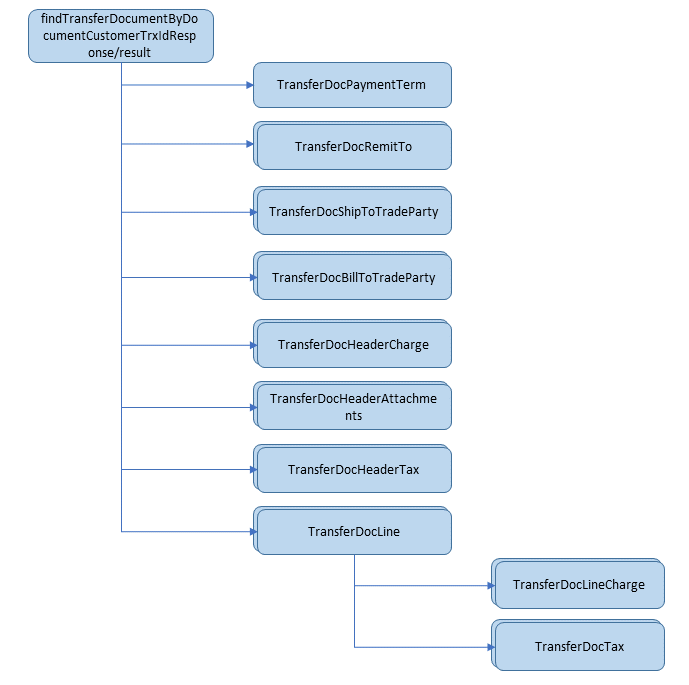

Here's the structure of the payload that's received from the application:
Refer to Figure 1 in Oracle-1-0-B2B-Invoice-In for the structure of the transformed payload that's sent to your trading partner.
