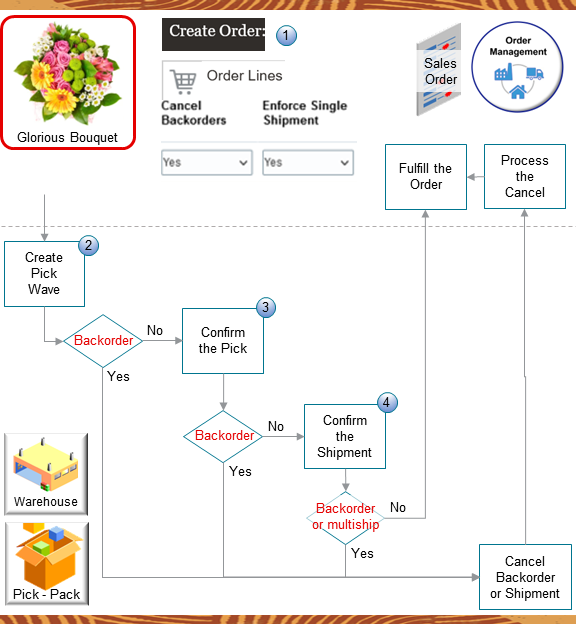

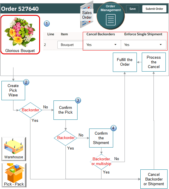

Here's a summary of how it works:
- Assume you sell an item named Glorious Bouquet. You create a sales order in the
Order Management work area, add the bouquet to an order line, set these
attributes on the order line, then submit the sales order:
Attribute Value Quantity 10 Cancel Backorders Yes Automatically cancel any quantity that you can't fulfill because on-hand quantity can't meet demand when Shipping creates a pick wave, confirms the pick slip, or confirms shipment.
Enforce Single Shipment Yes Automatically cancel any quantity that remains open on the order line after Shipping confirms and closes the first shipment.
- You create a pick wave in the warehouse. If Shipping:
- Hasn't put any quantity on backorder, then you proceed to confirm the pick.
- Has put some or all of the quantity on backorder, then Shipping allocates the quantity that's in stock, cancels the backordered quantity, then sends details about the cancel to Order Management so Order Management can process it and update the order line.
- You confirm the pick in the warehouse. If Shipping:
- Hasn't put any quantity on backorder, then you proceed to confirm the shipment.
- Has put some or all of the quantity on backorder, then Shipping prepares the quantity that's in stock, cancels the backordered quantity, then sends details about the cancel to Order Management so Order Management can process it and update the order line.
- You confirm the shipment in the warehouse. If Shipping:
- Hasn't put any quantity on backorder, then it finishes the shipment and sends the order line to Order Management so Order Management can update the line.
- Has put some or all of the quantity on backorder, then Shipping ships the quantity that's in stock, cancels the backordered quantity, then sends the order line to Order Management so Order Management can process the cancel and fulfill the order.
Shipping does these checks during various pick and pack operations in the warehouse.
Order Management sends the attribute values to Shipping after you submit the sales order. You can then go to the Inventory Management work area and view them in the Cancel Backorders attribute and the Enforce Single Shipment attribute on the Manage Shipment Lines page.
For background, see Using Shipping.
