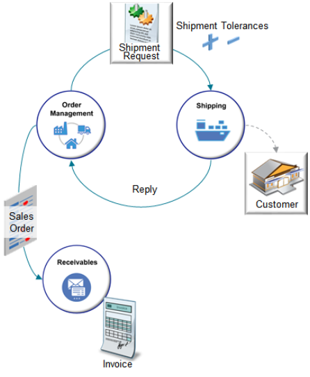

How it Works
How it Works
  1. Oracle Order Management creates and sends a shipment request to Oracle Shipping. The request includes shipment tolerances.
  2. Shipping enforces the tolerances, ships the line, then sends a reply to Order Management.
  3. Order Management evaluates the fulfillment line to determine whether to proceed to the next orchestration process step, or to split the line.
  4. Order Management sends the sales order to Receivables.
  5. Receivables invoices the transaction.

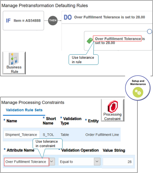

Transformation Rules and Constraints
Use tolerances in a pretransformation rule, posttransformation rule, or processing constraint. Use a tolerance value in a business rule or order management extension to create a condition and specify more detailed behavior than what you can set with Order Management parameters or in Product Information Management.
For example, add a business rule.
If the item is AS54888, then set Over Fulfillment Tolerance to 28.
Or add a processing constraint.
If the Over Fulfllment Tolerance attribute on the fulfillment line is equal to 28, then prevent the user from modifying the line.
