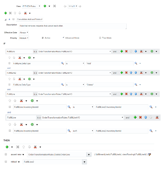

You will create this IF statement. It determines whether the change in fulfillment line 1 is Add.
Try it.
In the field to the left of
Is A, enterFulfillLine. -
In the field to the right of
Is A, click the down arrow, then click OrderTransformationRules.FulfillLineVO. -
Click Add Test > Simple Test.
Click Left Value.
In the Condition Browser, expand FulfillLine, then click DeltaType > OK.
In the Right Value attribute, enter
"Add". You must include the double quotation marks. -
Click Save.

You will create this IF statement. It determines whether the change in fulfillment line 2 is Delete.
Try it.
Click Add Pattern.
In the window below
And, enterFulfillLine2. -
Click Add Test > Simple Test, then click Left Value.
FulfillLine2, then click DeltaType > OK. -
In the attribute Right Value, enter
"Delete". You must include the double quotation marks.Click Save.

You will create this IF statement. It determines whether the inventory item in fulfillment line 1 is the same as the inventory item in fulfillment line 2
Try it.
Click Add Pattern.
In the window below
And, enterFulfillLine. -
In the Condition Browser, expand FulfillLine, click InventoryItemId, then click OK.
Click Right Value.
FulfillLine2, then click InventoryItemId > OK.Click Save.

You will create this IF statement. It determines whether the fulfillment line ID of fulfillment line 1 is different from the fulfillment ID of fulfillment line 2.
Try it.
Click Add Pattern.
In the window below
In the Condition Browser, expand FulfillLine, then click InventoryItemId > OK.
Click Is > Isn't.
Click Right Value.
FulfillLine2, click InventoryItemId > OK.Click Save.

You will create this action. It deletes fulfillment line 1 and fulfillment line 2.
Try it.
In the Then area, click Add Action > Assert New.
Click Select a Target, then click OrderTransformationRules.DeleteOrderLine.
Click Edit Properties.
In the Properties dialog, enter values, then click OK
Name
Value
fulfillmentLineId
fulfillmentLineId
viewRowImpl
fulfillmentLineId
Click Add Action > Retract.
FulfillLine2.Click Save.
