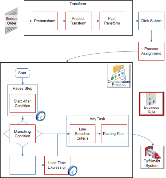

Here are the types of business rules you can use and where you can use them.
Note
Type of Business Rule |
Description |
Transform a sales order.
Order Management transforms each source order that you create in Order Management or that it receives from a source system so it can optimize order fulfillment. You can write a rule to:
For example:
For details, see Transformation Rules. |
Process Assignment |
Assign the orchestration process that Order Management runs to process fulfillment lines. For example:
For details, see Assign Orchestration Processes. |
Process a sales order.
Process a change order.
Set up a rule that affects processing, such as branch in an orchestration process, do a complex calculation that determines planning lead time, or manage a change that happens to the sales order. For example:
Routing Rule |
Set up a rule that routes a fulfillment request to a fulfillment system according to an attribute on the sales order, fulfillment line, or orchestration process. For example:
For details, see Overview of Connecting Order Management to Your Fulfillment System. |
