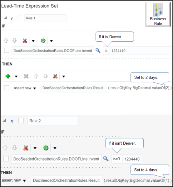

Assume your lead-time to ship the item varies depending on where the inventory organization is located, so you implement these business rules:
If the inventory organization is in Denver, then use a two day lead-time
If the inventory organization isn't in Denver, then use a four day lead-time

In the Lead-Time Expression dialog, click Add Rule > Expand.
If you write a rule for an orchestration process that orchestrates more than one fulfillment line, then use Advanced Mode. However, this example treats all fulfillment lines in the same way, so Advanced Mode isn't required. To use Advanced Mode, you would click Properties, add a check mark to Advanced Mode, then edit the rule.
In the If area, click Left Value.
In the Condition Browser, expand DOOSeededOrchestrationRules > DOOFline, click InventoryOrganizationId, then click OK.
DOOFline is an abbreviation for Distributed Order Orchestration Fulfillment line. Oracle replaced the name Distributed Order Orchestration with the name Order Management in an earlier update. Some rules still use the old name.
In the Right Value attribute, enter
1234440
.Assume 1234440 is the inventory organization ID for Denver.

In the Then area, click Add Action > Assert New.
Click Select a Target > DooSeededOrchestrationRules.Result.
Click Edit Properties.
In the Edit Properties dialog, in the ResultObjKey row, enter the value, then click OK.

BigDecimal.valueOf(2)

In the Lead-Time Expression dialog, in the Lead-Time Expression Set area, click Add Rule.
In the lower part of the dialog, in the Rule 2 area, click Expand.
In the If area of Rule 2, click Left Value, expand DOOSeededOrchestrationRules > DOOFline, select InventoryOrganizationId, then click OK.
Tip:In some attributes, you can copy the value from one attribute to another instead of using the drop-down list. For example, you can copy DooSeededOrchestrationRules.DOOFLine.inventoryOrganizationId from Left Value of the first rule, then paste it into Left Value of the second rule.
Click the down arrow for the operator, then click isn't.
1234440

In the Then area for Rule 2, click Add Action > Assert New.
In the Edit Properties dialog, in the ResultObjKey row, enter the value.

BigDecimal.valueOf(4)
Click OK > Save.
