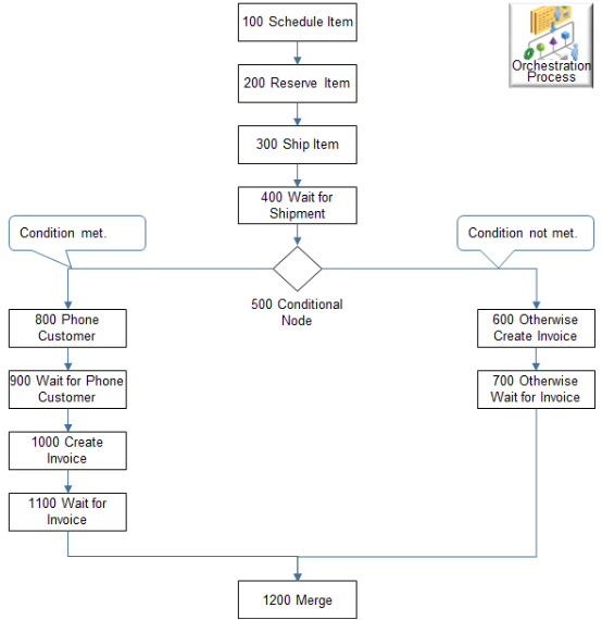

The Conditional Node indicates that an orchestration process is about to branch. The first step of the branch contains the condition.
If the flow.
Meets the condition. The orchestration process runs the steps on the branch that notifies the representative.
Doesn't meet the condition. The orchestration process runs the steps on the branch that don't notify the representative.

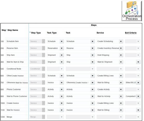

Add the Orchestration Process Steps
You will add these steps.
Add a step.
Attribute
Value
Step Name
Schedule Item
Step Type
Service
Task
Schedule
Service
Create Scheduling
Add another step.
Tip:To maintain the correct sequence when you add each step, click the step you most recently added, then click Add Row.
Attribute
Value
Step Name
Reserve Item
Step Type
Service
Task
Reserve
Service
Create Inventory Reservation
Add another step.
Attribute
Value
Step Name
Ship Item
Step Type
Service
Task
Ship
Service
Create Shipping
Add another step.
Attribute
Value
Step Name
Wait for Item to Ship
Step Type
Service
Task
Ship
Service
Wait for Shipment
Exit Criteria
Shipped
Fulfillment Completion Step
Contains a check mark.
Add another step.
Attribute
Value
Step Name
Conditional Node
Step Type
Conditional
Add another step.
Attribute
Value
Step Name
Phone Customer
Step Type
Service
Task
Activity
Service
Create Activity
Evaluation Sequence
1
Add another step.
Attribute
Value
Step Name
Wait for Phone Customer
Step Type
Service
Task
Activity
Service
Wait for Activity
Exit Criteria
Completed
Add another step.
Attribute
Value
Step Name
Create Invoice
Step Type
Service
Task
Invoice
Service
Create Billing Lines
Add another step.
Attribute
Value
Step Name
Wait for Invoice
Step Type
Service
Task
Invoice
Service
Wait for Billing
Exit Criteria
Billed
In the Step Definition list, click the Conditional Node step, then add another step. This step creates the Otherwise branch.
Attribute
Value
Step Name
Otherwise Create Invoice
Task Type
Invoice
Task
Each task name that you use with a task type must be unique. You used the Invoice task with the Invoice task type earlier in this procedure, so you must create a new task name.
To do this, In the Task attribute, click the Search down arrow, then click Create. In the Create Task Name dialog, enter values.
Code: 1
Display Name: Otherwise Create Invoice
Task Type: Invoice
Click Save and Close.
Service
Evaluation Sequence
2
Otherwise
Planning Default Branch
In the Step Definition list, click the Otherwise Step, Create Invoice step, then add another step. This step creates the Wait for Invoice Step on the Otherwise branch.
Attribute
Value
Step Name
Otherwise Wait for Invoice
Step Type
Service
Task
Service
Wait for Billing
Exit Criteria
Billed
In the Step Definition list, click the Wait for Invoice step, then add another step. This step merges the branch back to the main flow.
Attribute
Value
Step Name
Merge
Step Type
Merge

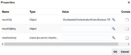

In the Then area, click Add Action > Assert New.
Click Select a Target, then click DooSeededOrchestrationRules.Result.
Click Edit Properties.
In the Properties dialog, in the ResultObj row, click Value.
In the Condition Browser dialog, expand DooSeededOrchestrationRules > Boolean, click True, then click OK.
Make sure the Properties dialog contains these values.
Name
Type
Value
resultObj
Object
DooSeededOrchestrationRules.Boolean.TRUE
resultObjKey
Object
Leave this cell empty.
viewRowImpl
oracle.jbo.server.viewRowImpl
For example:
Click OK.

Verify that you correctly defined the orchestration process steps and flow.
In the header of the Edit Orchestration Process Definition page, click Actions, then click Generate Process Diagram.
Make sure the diagram includes the same steps and logic that the diagram at the beginning of this topic displays.
Test the nonbranching flow.
In the Order Management work area, create a sales order that's valued at less than $50,000.00.
Verify that Order Management ships the item without requesting that you call the customer.
Test the branching flow.
Create a sales order that's valued at more than $50,000.00.
Verify that Order Management doesn't ship the item until the activity that the Wait for Phone Customer step references reaches a Completed state.
