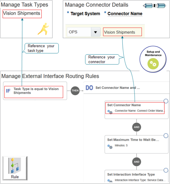

Set up a connector that includes the URL to your fulfillment system and any sign in requirements, such as user and password. Order Management uses the connector to find your fulfillment system and communicate with it.
Set up a routing rule that routes calls from your fulfillment system to the connector according to the task type that you specify.
At run time, Order Management and your fulfillment system use the connector to communicate status updates throughout the fulfillment lifecycle, such as Started, Picked, Awaiting Shipping, and Shipped.

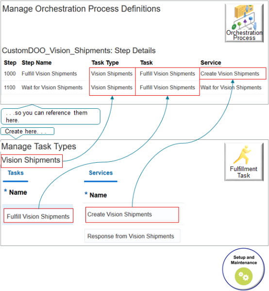

Manage Task Types
To start, you create task type, task, and services so you can reference them later in this procedure when you set up the orchestration process.
Try it.
Go to the Setup and Maintenance work area, then go to the task:
Offering: Order Management
Functional Area: Orders
Task: Manage Task Types
On the Manage Task Types page, click Actions > Add Custom, set values, then click Save.

In the Details area, on the Services tab, add the services you will use to communicate with your Vision Shipments fulfillment system.

Click Tasks, click Actions > Add Row, set the values, then click Save and Close.
Code
Name
Display Name
Intermediate Replanning
Fulfill_Vision_Shipments
Fulfill Vision Shipments
Doesn't contain a check mark.
Order Management uses the task to communicate status values with your fulfillment system.

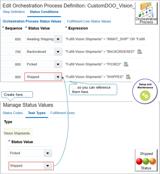

Manage Status Values and Status Conditions
Create status values on the Manage Status Values page so you can reference them when you set up the orchestration process.
Note
Add status values on the Manage Status Values Page.
Later in this procedure, reference your status value on each orchestration process step.
For details, see Fulfillment Tasks.

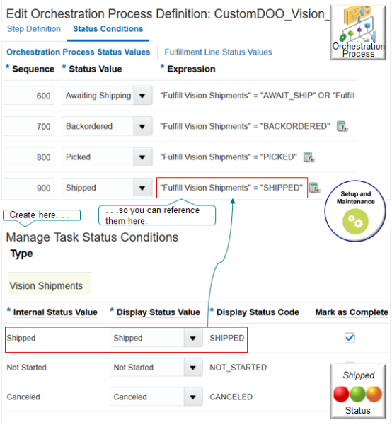

Manage Status Conditions
Create status values on the Manage Task Status Conditions page so you can reference them when you set up the orchestration process.
Task: Manage Task Status Conditions
On the Manage Task Status Conditions page, click Query by Example, enter
Vision Shipmentsin the Type column, then press the Enter key. -
In the Status Conditions area, notice that the Setup and Maintenance work area automatically created a set of conditions for you when you created the Vision Shipments task type.

Modify steps.
In the Process Details area, modify values in the row that contains Create Shipment Request in the Step Name attribute.
Attribute
Value
Step Name
Task Type
Vision Shipments
This is the task type you created earlier in this procedure.
Task
This is the task you created earlier in this procedure.
Service
Create Vision Shipments
This is the service you created earlier in this procedure.

Modify values in the row that contains Wait for Shipment Advice in the Step Name attribute, then click Save.
Attribute
Value
Step Name
Wait for Vision Shipments
Task Type
Vision Shipments
Task
Service

Add Status Values for the Orchestration Process
Click Status Conditions, then, on the Orchestration Process Status Values tab, verify values in the Expression column.
Sequence
Status Value
Expression
600
Awaiting Shipping
"Fulfill Vision Shipments" = "AWAIT_SHIP" OR "Fulfill Vision Shipments" = "VARIOUS"

Picked
"Fulfill Vision Shipments" = "PICKED"
900
Shipped
"Fulfill Vision Shipments" = "SHIPPED"

Recall that in this example you created a fulfillment task named Fulfill Vision Shipments, so enter
"Fulfill Vision Shipments" =. -
Expand CustomDOO_Vision_Shipments, Fulfill Vision Shipments, click AWAIT_FULFILLMENT [ Awaiting Fulfillment ], then click Insert Into Expression.
Verify that the Expression window contains
"Fulfill Vision Shipments" = "AWAIT_FULFILLMENT", then click OK.
Add a new row.
Click Actions > Add Row, then set the values.
Attribute
Value
Sequence
1700
Status Value
Awaiting Fulfillment Line Aggregation
In the Expression column, use the Calculator icon to add
"Fulfill Vision Shipments " = "AWAIT_FLINE_AGGREGATE".
Click Save.
Add Status Values for the Fulfillment Line
Click Fulfillment Line Status Values, then click Edit Status Rule Set.
On the Edit Status Rule Set page, verify values.
Sequence
Status Value
Expression
1200
Awaiting Shipping
1300
Backordered
"Fulfill Vision Shipments" = "BACKORDERED"
1400
Picked
1500
Shipped
1800
Partially Picked
"Fulfill Vision Shipments" = "PARTIAL_PICK"
1900
Partially Backordered
"Fulfill Vision Shipments" = "PARTIAL_BACK"
Sequence
Status Value
Expression
1930
Click Actions > Add Row, set the values, then click Save and Close.
Sequence
Status Value
Expression
1960
"Fulfill Vision Shipments" = "AWAIT_FLINE_AGGREGATE"

Set Up Connector
Task: Manage External Interface Web Service Details
For details about how to set up a connector, see Overview of Connecting Order Management to Your Fulfillment System.
On the Manage Connector Details page, click Actions > Add Row, set the values, then click Save and Close.
Attribute
Value
Target System
OPS
OPS means Order Orchestration and Planning.
Connector Name
Vision Shipments
Connector URL
Enter the URL that locates your fulfillment system.
Connector Description
Connect Order Management to the Vision Shipments fulfillment system.
User Name
Name of a user you have set up on your fulfillment system.
Password
Password you need to access your fulfillment system.
Invocation Mode
Synchronous Service
Set Up Routing Rule
Create a routing rule that routes the fulfillment request to your connector according to task type.
Note
Reference the task type that you created on the Manage Task Types page when you create the If statement.
Reference the connector that you created on the Manage Connector Details page when you set the connector name in the Do statement.
Try it.
Task: Manage External Integration Routing Rules for Sales Orders
For details about how to set up a routing rule, see Use Visual Information Builder.
On the Manage External Interface Routing Rules page, click Create New Rule.
Set the values, then click Save and Close.
Attribute
Value
Name
Route Sales Orders to the Vision Shipments Fulfillment System
Create the If statement.
If Task Type is equal to Vision Shipments -
Create the Then statements.
Set Connector Name to Vision Shipments Set Maximum Time to Wait Before Allowing Cancel to 5 Minutes Set Interaction Interface Time to Service Data Object
