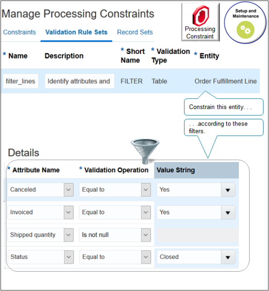

Constrain Changes That You Allow on Fulfillment Lines
Note
Use the Manage Processing Constraints task in the Setup and Maintenance work area.
Set the Entity attribute to Order Fulfillment Line.
Use the Details area to add your filters.
Assume that if the fulfillment line is closed or canceled, or if Order Management already shipped it or invoiced it, then you don't want your users to modify a value on the line, such as Ship-to Site.
Attribute Name
Validation Operation
Value String
Canceled
Equal To
Yes
Invoiced
Equal To
Yes
Shipped Quantity
Is Not Null
Status
Equal To
Closed
