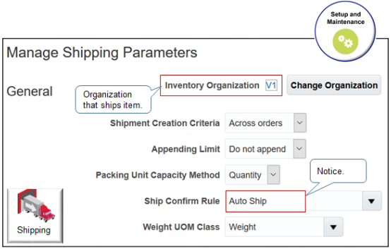

  1. Identify the ship confirm rule that your inventory organization uses.
    • Go to the Setup and Maintenance work area, then go to the task:
      • Offering: Manufacturing and Supply Chain Materials Management
      • Functional Area: Shipping
      • Task: Manage Shipping Parameters
    • Set organization to Vision Operations.
    • On the Manage Shipping Parameters page, notice the value in the Ship Confirm Rule attribute.
      For this example, assume the value is Auto Ship.

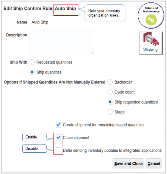

  2. Modify the ship confirm rule.
    • In the Setup and Maintenance work area, go to the task.
      • Task: Manage Ship Confirm Rules
    • On the Manage Ship Confirm Rules page, search for Auto Ship, then open it for editing.
    • In the Edit Ship Confirm Rule dialog, set the values, then click Save and Close.
      Option
      Value
      Close Shipment
      Enabled
      Defer Sending Inventory Updates to Integrated Applications
      Disabled
