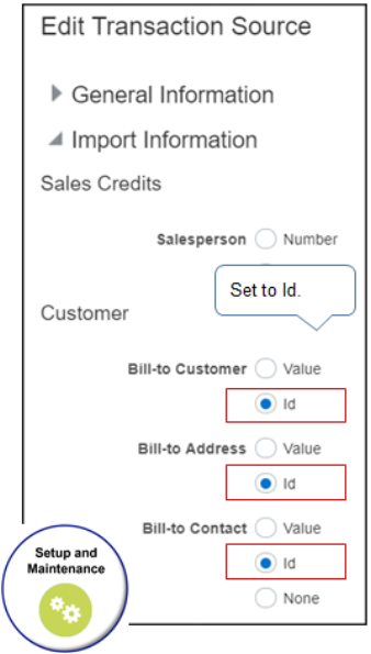

I encounter an error when I run the Import AutoInvoice scheduled process.
This error happens when you set the value instead of the Id during set up. Try this:
For details about the scheduled process, see Guidelines for Setting Up Order-to-Cash and Update Intercompany Receivables Invoice Import Details. |
